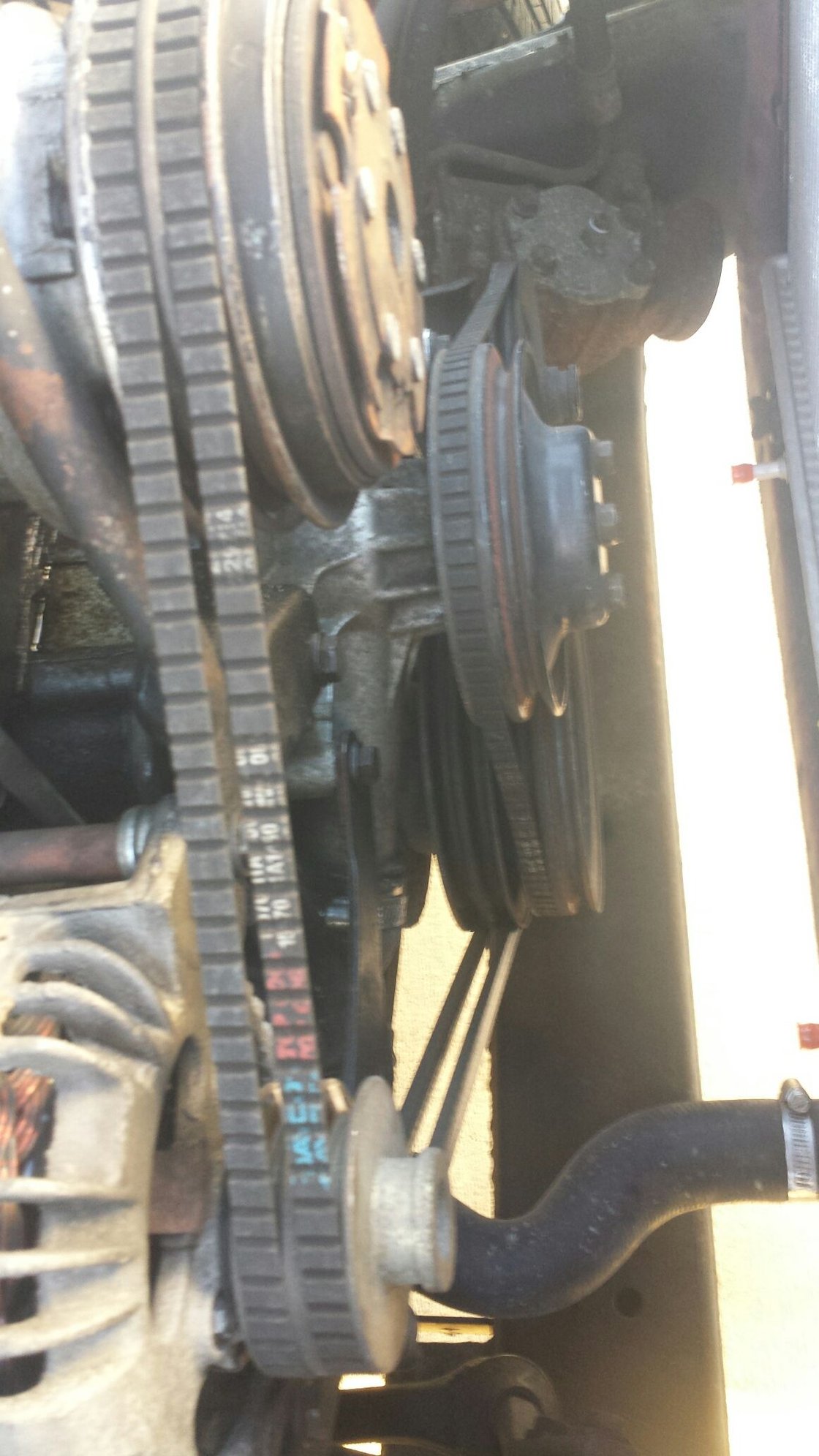

I wanted to add a picture from my truck to hopefully show what ralph is saying....... Mine is a 87...
Ah ok, now I see what you mean. The wp pulley only has 1 belt driving it. The same one as the ps pump.
Those did take the same wp as the 318s and 360s of the time. Most with those engines had 2-3 belt grooves on the wp. Get a wp pulley from a 318 or 360 with 2-3 grooves, and you'll be able to do what I posted. Not a big deal
