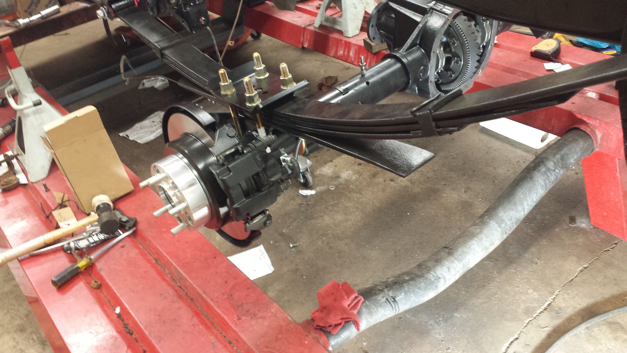

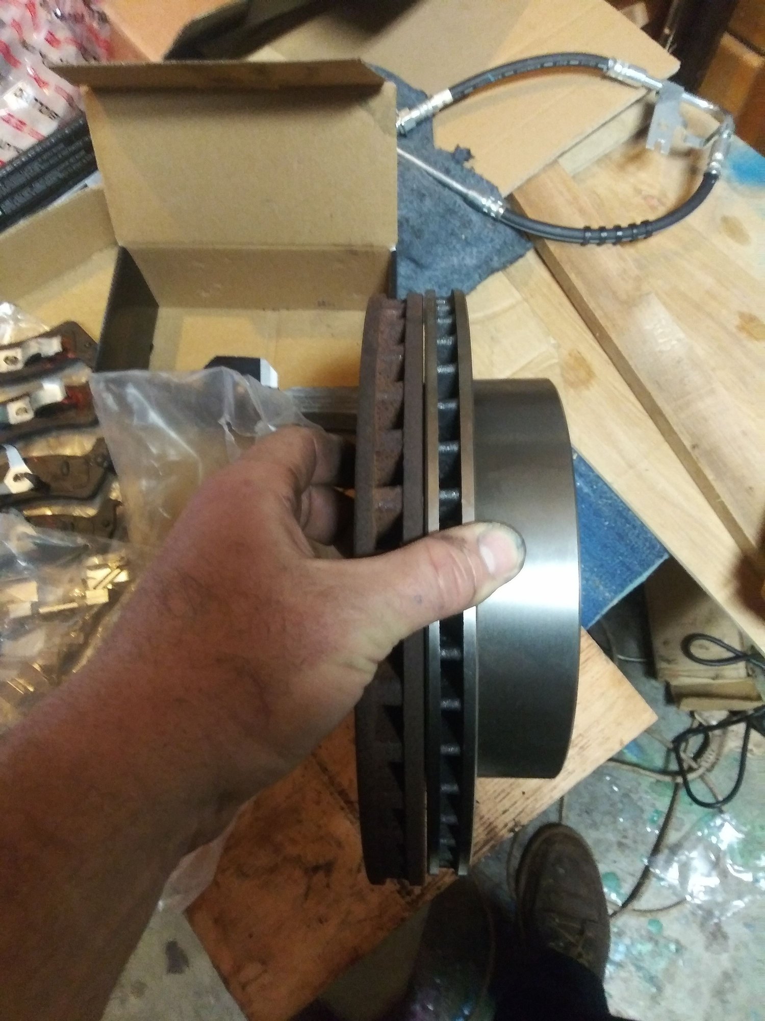

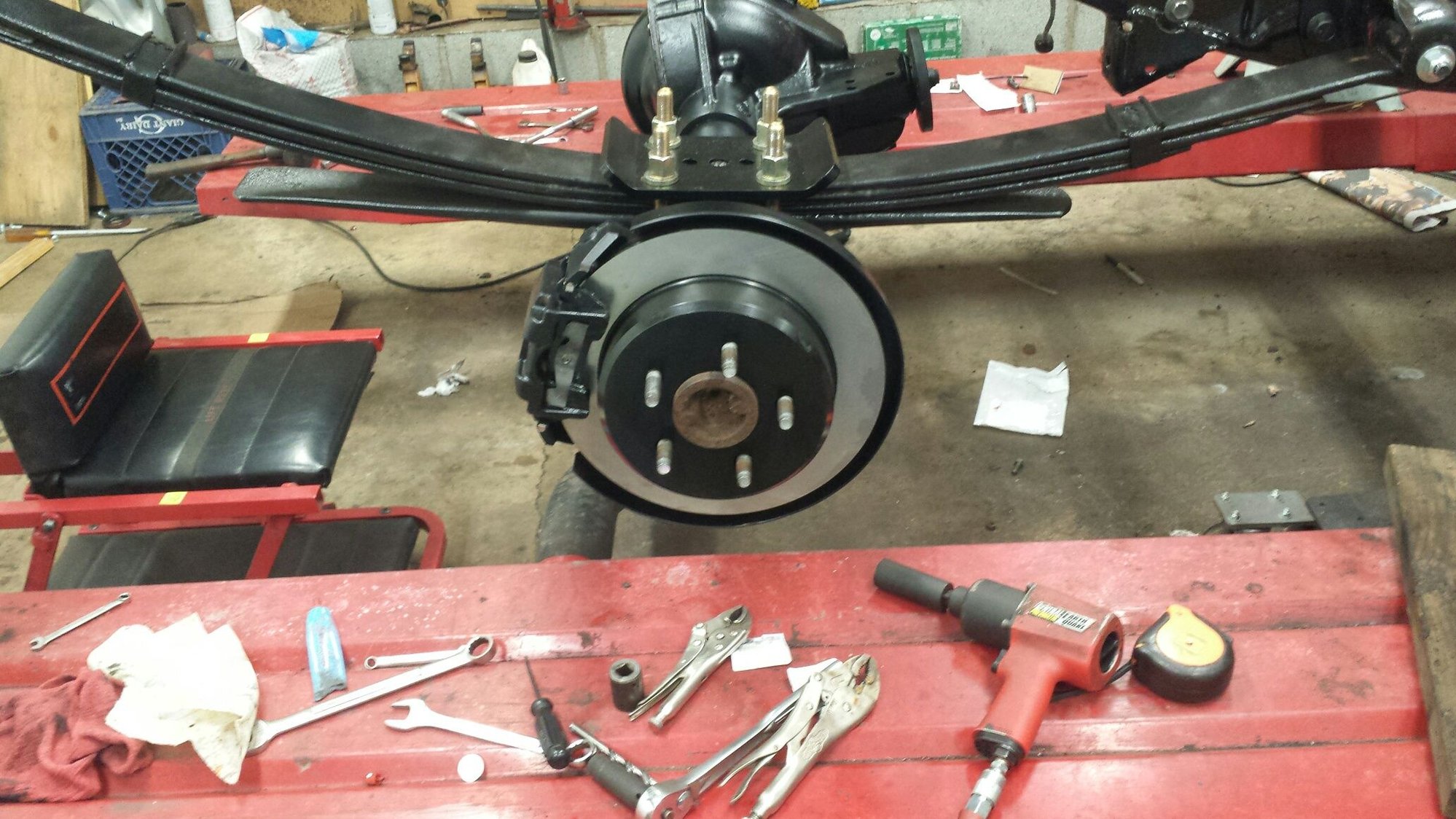

I have 92 4x4 5.2l with 6x4.5 lugs. Dana 60 rear Dynatrac axles that have ford explorer pads and calipers. Which leads to solid .5in rotor 1.5in hat disc/e brake and problem is I can only find a 5lug
and nowhere to drill them(b.s.) then to have them customs made is $204 a piece(t.f.b.s)
2005 Nissan exterra fit my 6x4.5 but it was vented and explorer calipers w/pads would not fit....?please help

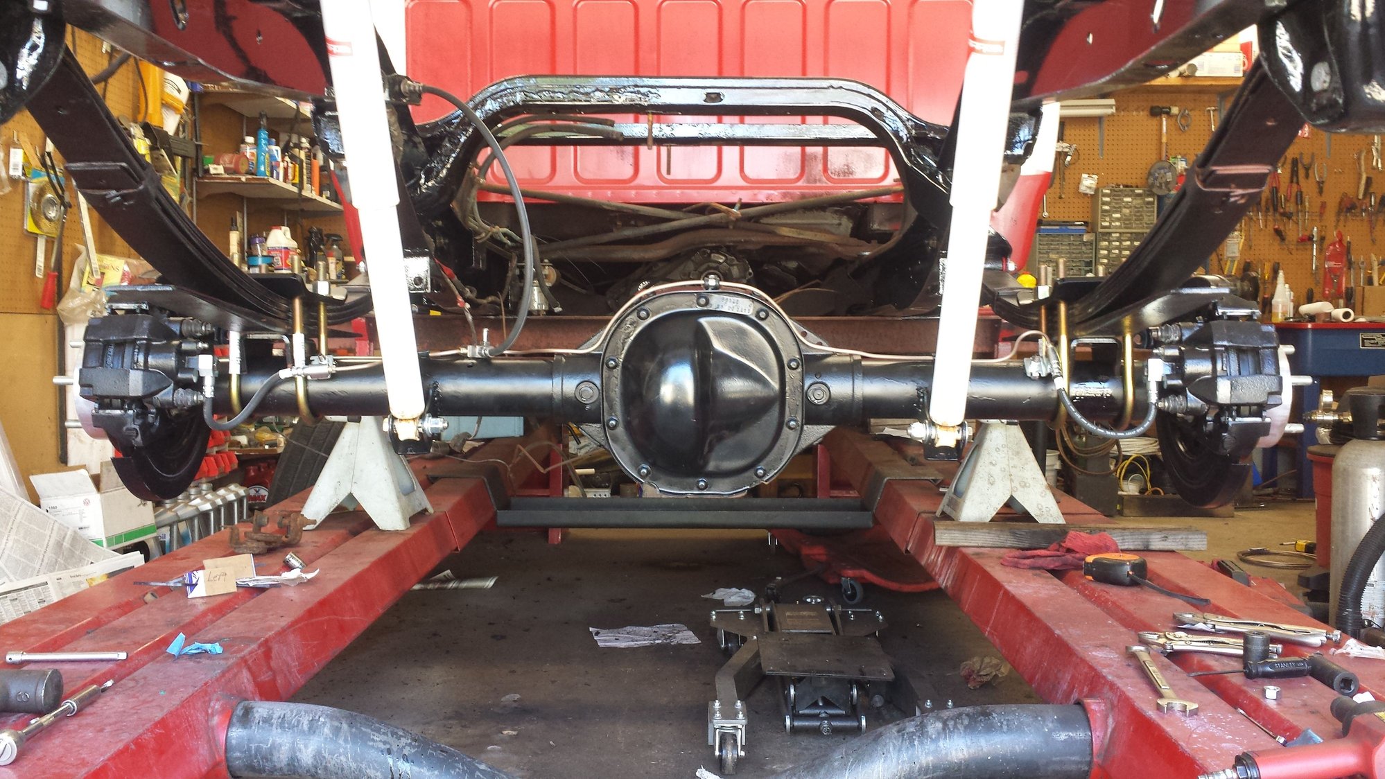

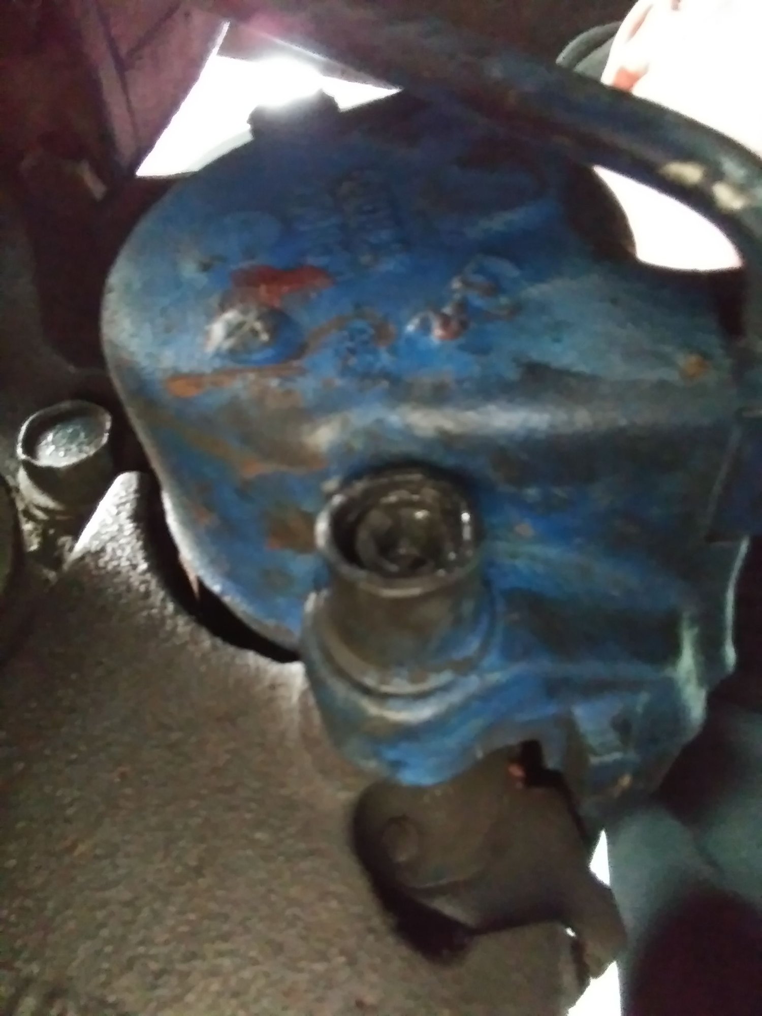

Something is not right...... You said it was a solid rotor, and your picture is vented...... Explorer has a solid rotor.
That caliper does not look like a explorer. Enclosed is a picture of a 8.8 out of a explorer in my truck.... The second picture shows the explorer rotor is solid.. The third picture is the best I have of the caliper on the inside.
Are you sure that is a dana 60? If you could show a picture of the diff. cover it would help....... so we could see the bolt pattern.
Any chance what you have is a 9.25 out of a 03 or so dakota or durango? It looks more like that too me. But the pictures you supply are hard to tell much from.
