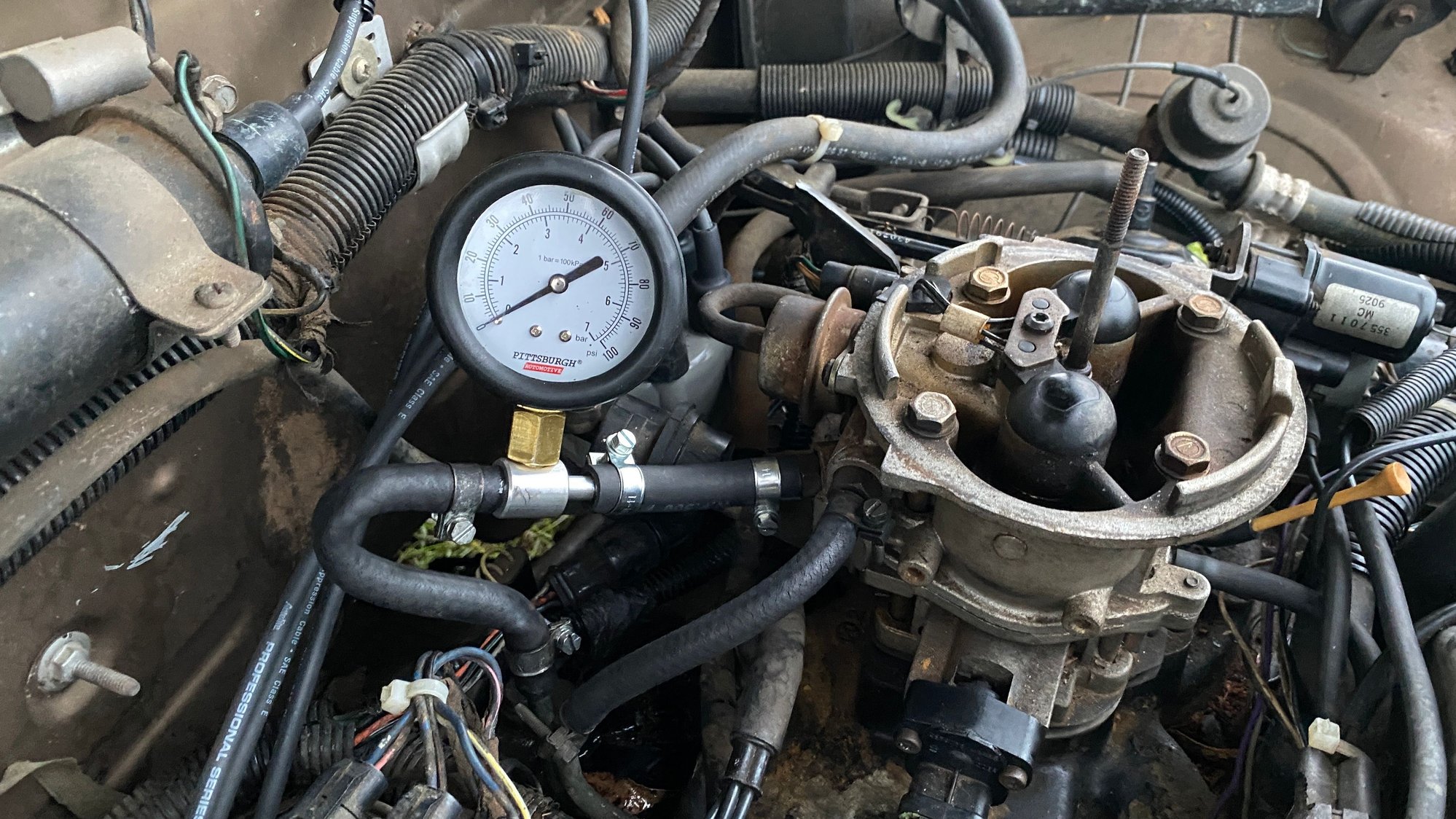

I just finished testing the pressure and got a result of 70 PSI.
Looks like I need a new fuel pressure regulator!
Fuel Pressure Test
Yah. As soon as the pump pressurizes, the poor injector just gives up the ghost.
Ideal is 14.5PSI on the TBI motors, so ...
It's like opening a door out with almost 5 atmospheres of pressure on the other side!
RwP
RwP
