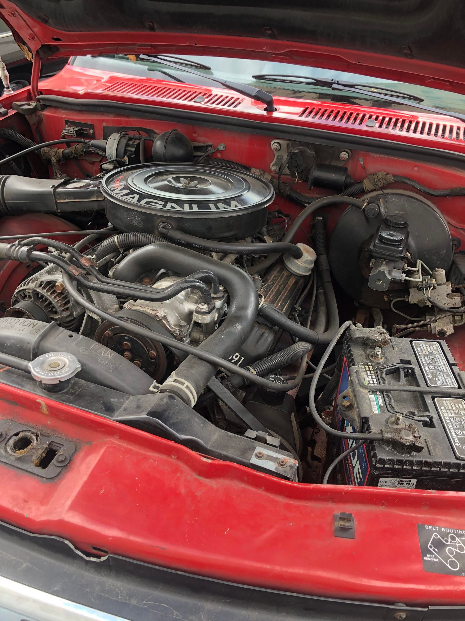

Hey all, new member and a new owner of a '93 Dodge Dakota. SLT with a 318 (doh) V8, 125K miles, and I'm only the second owner. I got really lucky as the previous owner worked for Chrysler and kept the vehicle in impeccable condition, so there is very minimal surface rust and the interior is practically brand new.
I'm planning on changing fluids, spark plugs, filters, and just giving everything a cleanup. Right now, the major problems are that the ABS and Parking Brake light stay on regardless if they are engaged or not, so based on previous threads I'm assuming I have to check the sensors themselves and the fuses. Anything else I might be missing there?
Also, the engine temperature gauge doesn't function (always bottoms out), so I think for that I want to check and make sure the sensor is at least connected/functioning and then possibly check the gauge itself at some point.
Are there any other major things I should put on my list for changing/upgrading? I realize suspension/shocks will probably have to be replaced soon and I believe the exhaust is leaking slightly, so I may replace the whole system there. I realize a lot of these things have already been posted in other threads, I just wanted to make sure I introduced myself and appreciate any and all help y'all provide! I'll have some pics up later after I get through work today.

The coolant sensor, "I think" if its a 1 wire sensor, you can unplug it, turn ignition switch to on and it should peg one direction or the other. Then ground the wire and it should peg the other direction. If it does, its probably the sensor.

If it's a stock motor, then quite likely it's a 5.2 liter, or 318 Cubic inch. 93 would make it a magnum engine, so, I do believe you have two temp sensors on that engine. One will be by the heater outlet fitting on the intake manifold. The other is buried down behind the A/C compressor, near the thermostat housing. The one-wire sensor is for the gauge in the dash. Two wire sensor is for the PCM.
