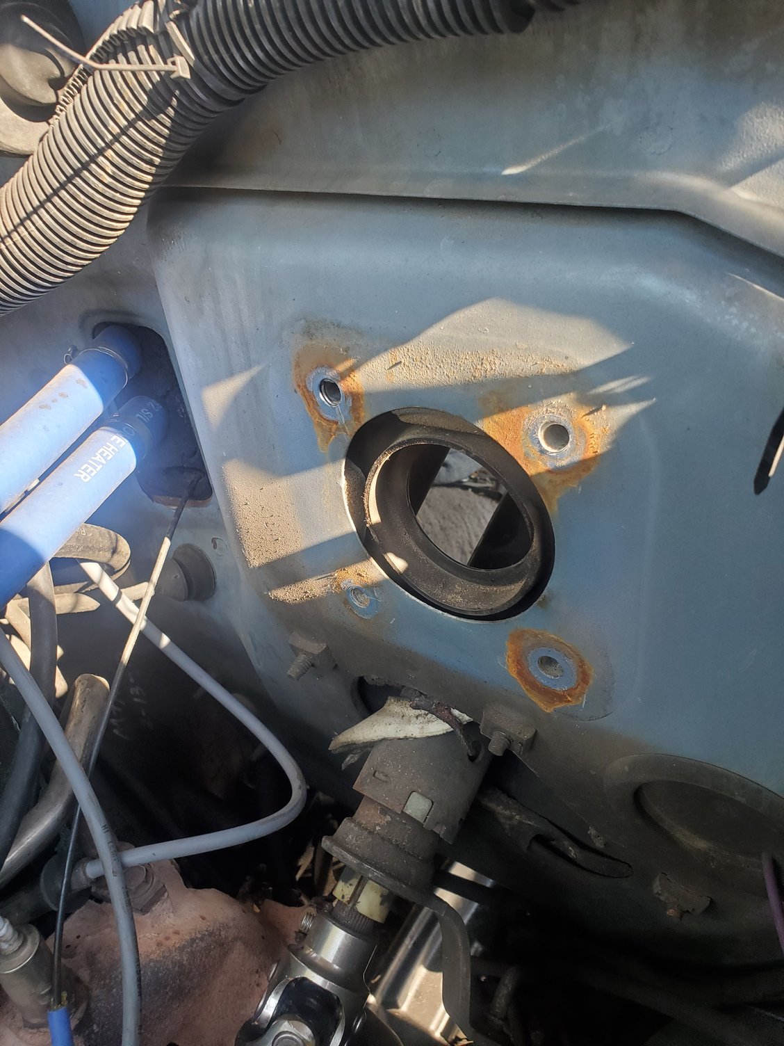

Firewall looks bare here.
That's the top U joint on my intermediate shaft. The purple wire through the grommet is for my subwoofer.
