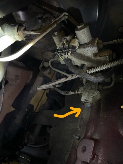

OK, I need to bug you some more. I stumbled on this video and found it interesting. Please watch. It's less than 7 minutes and the guy does a nice job explaining things. It's for a Chevy but I have the same feature on my Dodge truck.
His final solution was a button that pushed the proportioning valve piston back in place. I have a button on mine too. See photo below. Yellow arrow points to it. Is it possible I did what this guy is talking about and it's a matter of pushing that button? I busted off all my brake lines and lost all my fluid. My reservoir was dry. I cannot get them to bleed. Same problem as this guy. I don't know at what point that piston gets pushed over. I know I started on the front brakes. I removed the brake hose from the caliper and not long after that I pushed the caliper piston all the way back to make room for my new pads. Could that have triggered it (edit: No because the brake hose was already disconnected)? I'd surely be interested in your thoughts as I am busting my brain trying to figure out what is going on that keeps me from bleeding my brakes.

Both rears on the same circuit. Only one line running to the rear.
Pull the drums, see if you see any fluid in there.
When you have the wife on hand, try the pump the pedal thing again, but, no tubing. Put your finger right on the bleeder valve. Couple wraps of teflon tape on the bleeders would be a good plan regardless.

Is there a restriction in the flow TO the master cylinder???
Something really strange is going on there.
