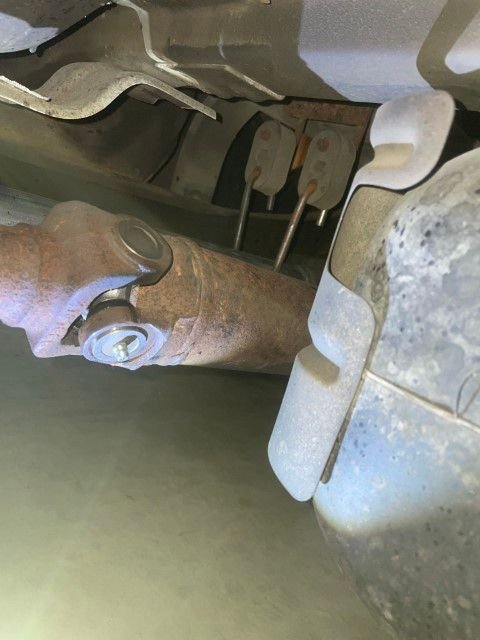

One more question. I'm no u-Joint aficionado but I have seen enough of them to know what they look like. I cannot say I have ever seen one with just one grease zerk on the endcap (Note bottom-most endcap with the zerk). None of the other three have them and there are no zerks inside. How common are these? I'd be curious to know the grease path of this one.
UPDATE: I think that's a Moog U-Joint (Super Strength line). Grease just shoots down the middle and crosses over to the middle of the other three bearings.

RalphP's Avatar
RalphP
Joined: Jan 2013
Posts: 4,737
Likes: 374
From: Northwest Louisiana
You got it.
Even in the web, it crosses the web and pushes out all four caps slightly when done right.
And until you see some sneaking out the cap, it's not done.
(I'd spin the shaft a few times and hit it one more lick if it were me; but I'm paranoid.)
