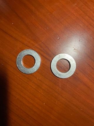

Question of the Day:
This is a fine time to ask this question after I already installed the ball joints a month+ ago. Anyway, these washers came with my ACDelco upper ball joints. I never put them on because 1) I semi forgot, and, 2) not sure where they're supposed to go. My Proforged lowers did not come with washers. Where do these washers go? Between the boot and the knuckle? Or were they meant as an optional spacer in the event the castle nut cleared the cotter pin hole in the stud? Gotta ask now because I get a second chance.
Old Nov 16, 2021 | 09:55 AM
  #250
onemore94dak's Avatar
onemore94dak
Joined: Sep 2013
Posts: 2,723
Likes: 152
" Anyway, these washers came with my ACDelco upper ball joints. I never put them on ..."
Spare Parts
