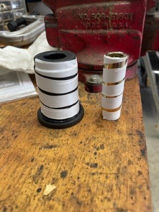

Can’t say those rear LCA bushings are exactly wedged in those shells. They slide in and out without much effort. But they can’t go very far once installed. That ES grease with the teflon tape wrapped around the bushing n sleeve is super slick.
OK, this can't be right. If I turn the LCA on its side the rear bushing drops out from gravity alone. Takes about 15 seconds but it comes out of its own volition. Yes, the inner sleeve is installed. How can this be right? The front LCA bushings dont do that. I think I'm going to have to take those existing shells out of the rear and press in the shells that ES supplied with the kit. Those are tighter. Just hope it presses in. Maybe this explains why ES supplies you with rear shells in the kit. Think I'll call them in the morning and ask for the hell of it.

Hopefully the teflon tape works. I have it wrapped around every bushing. Meanwhile, my Ingersoll Rand air hammer showed up. It took me 3 - 4 mins each to knock out those rear LCA shells. Had I done it by hand it would have took me 3 - 4 hours and a week in traction. Screw that! Get an air chisel.
For the record, the OEM rear LCA shells do not work. The bushing is way too loose...falls out on its own. You need to remove the OEM shells from the arm and press in the ones that are included in the 5.3115 ES bushing kit. Rear LCAs only. Much better! Oh, and the rumors that ES does not give you enough grease are true. Buy more!
