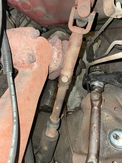

It might be moot if I end up detaching the the lower steering shaft from the upper steering shaft. Pics in next post.
And yes, access - as you point out, could very well be a problem.

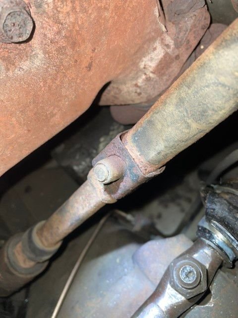

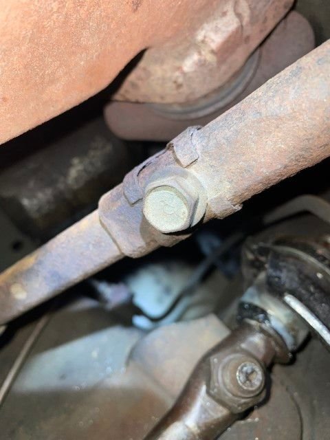

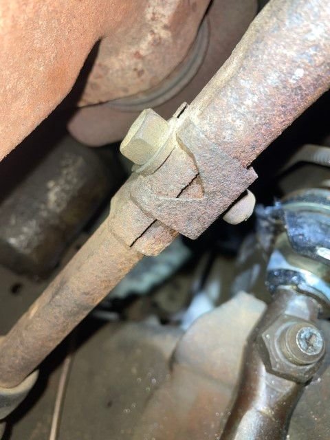

All photos...upper shaft goes to top of picture, lower shaft goes to bottom of photo. Pix taken from above looking into engine compartment.
This connection is squirrely to me. Can't say I've seen anything like this before. Yes, it looks like a pinch connection, but...

That looks just like my 1988's original intermediate shaft.
You're SUPPOSED to be able to remove that screw and slide the two parts apart.
A local machine shop finally figured out that it'd be easiest to remove with a torch ... "Can't be tight if it's a liquid!"
RwP

Oh, great! My confidence in getting my R&P off and/or detaching the steering shaft so I can lift the cab for body mounts has really soared thru the roof!

Maybe I just detach the R&P from the frame and see what happens. The hoses and tie rods can go along for the ride and maybe the steering shaft will tag along. Might help to lift/support the detached rack a little too so it doesn't weigh down the steering shaft.
Pump twice, inspect. Pump twice, inspect. Pump twice, inspect. Rinse & repeat.
