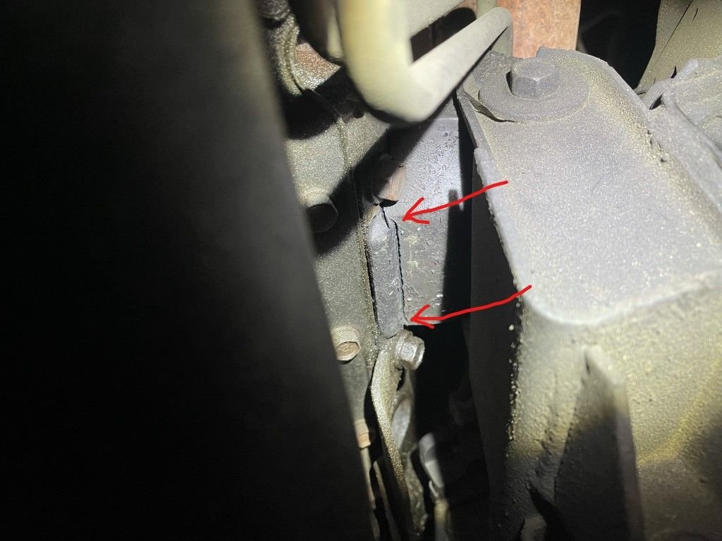

Here is a pix of my LH motor mount. Not sure how well you can see it but there is a crack between the arrow head points. I don't know what the rubber geometry is and I have not noticed the engine dancing around or anything but I suspect this is not good. Could this be the source of my crunching and creaking when I turn in and out of parking spaces?? As good as anything I can think of but I think the cab mounts might be a better possibility.
