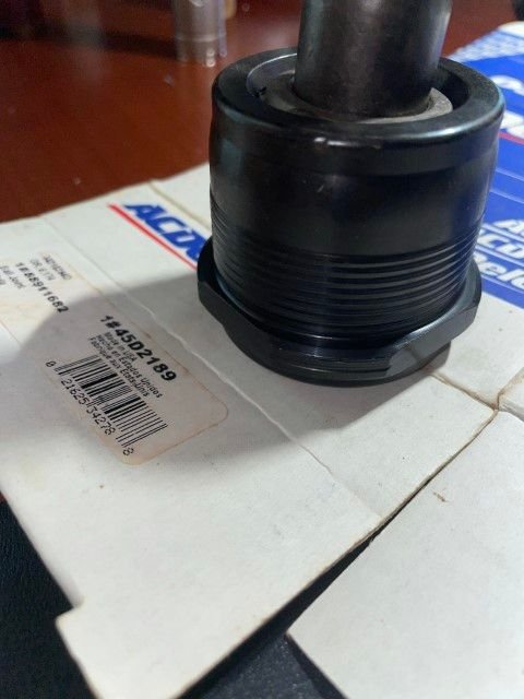

Here is the lower AC Delco balljoints they sent me.
Wrong! Correct number per their application chart. Probably the correct part for that number. But this is a thread-in balljoint. Mine is a press-in. I even went back to my truck and looked again. Mine is a press-in no ifs, ands, or buts. I think they sent me uppers cuz they're the same dimensions. AC Delco's application chart is wrong. End of story. So this part goes back. Instead, I ordered two lower balljoints from Holley (Proforged 101-10085) per both my research and Ralph's. The photograph shows this Proforged balljoint as being a press-in (unlike the AC Delco photo). I like my odds that it's the correct part. https://www.holley.com/products/susp...arts/101-10085
