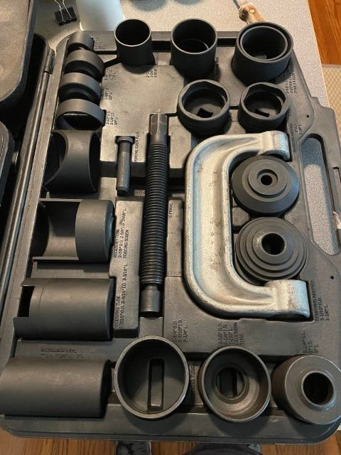

This is the Powerbuilt Kit 46 I have on loan from Advanced Auto. Truthfully, it is the best Press Kit I've seen any of these parts stores have and I think I looked at all of them. Plenty of sizes. Even has the 2-9/64" ball joint socket (and a 1-59/64ths). Who the hell comes up with these sizes?

The guy who designed Kit 46 was drinking martinis too. The receiver pieces are too long (or the clamp throat is too short). By about 1/4”. Tried everything. No go. Gonna run to Home Depot and find a pipe or sumpin I can McGyver. The rest of it going as well as can be expected.
Seen this on a few old Dodge truck n van videos. Pieces just too long. Cant get clamp jaws around the ball joint with receiver pieces.
