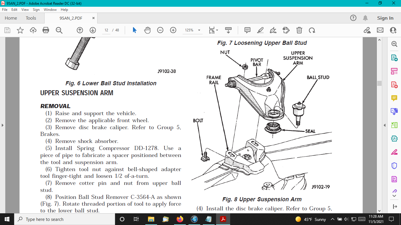

You know, I'm looking at that upper control arm. It looks like the only things holding it on the truck are the upper ball joint and the two alignment nuts on the pivot bar (see 1995 illustration below, still waiting for my 1993 FSM). Remove those three things and the arm should come right out. No brake lines attached to the arm. The shock is bolted on that frame bracket and not the arm itself.. Not sure how those alignment bolts are secured once the nut is removed. Wouldn't want them falling in the abyss.
This looks pretty simple especially since I shouldn't have to fight the ball joint cuz that's just been changed out. A couple pops with a hammer should de-knuckle it I would think. Once off the truck it would be easy to remove/replace the upper control arm bushings. No? Would need an alignment unless I can matchmark stuff and get it back in the same position. I welcome advice, again.

Looks like the bolts have a collar that prevents them from spinning when you take of the nuts, but, of course, they will NOT prevent them from falling out, and disappearing, never to be seen again. At least, not until after the replacement bolts have been installed.
I'd say go for it. Get some of the graphite impregnated poly bushings, and tighten up the steering a wee bit as well. (do both sides..... )
