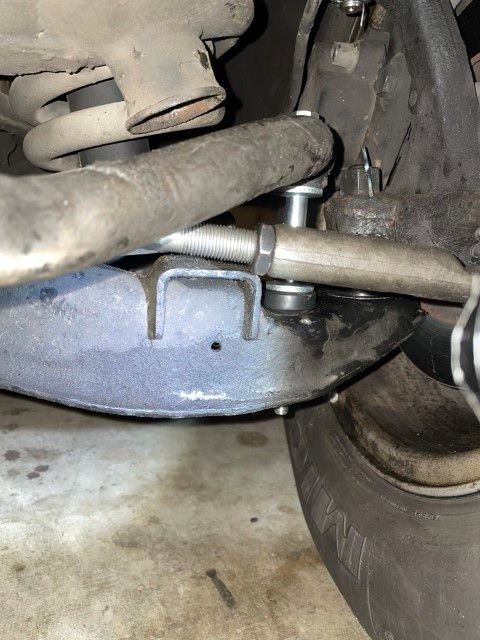

Ralph, here is my snubber setup. Cup on frame above the lower control arm. Note it has a couple barb-like tabs on the side...shove bumber in and it can't come out. Next photo shows what is left of the original snubber that I pried out. It's the piece that fits inside the cup. Note the cavity for clearance where the bolt in the cup is. Ever see one like this?

I don't blame you for fixing the old one; but do note that now, Craftsman is being made in the USA again.
As to the suspension snubber, no; but that's not much Heck, mine may have supposed to have one, and I didn't notice it because both were missing.
*checks exploded parts diagrams*
Nope, my upper was a single bolt into the upper control arm; the lower pops into a retainer on the lower control arm for 1987-1993; yours is 1994-1996 (again, according to the exploded parts diagram.)
Huh. Today I Learned (TIL) .

I've owned (and inherited) a metric assload of Craftsman tools. All 25+ years old. Good stuff. Heard they went to crap. Did not know they came back to US. Are they back to high quality again?
I'll have to dig more for that snubber. Not sure how many times I've needed that snubber. It's not like I offroad the thing. Would be easy to drill a hole in the receiving piece on the control arm and put on one of those bolt-on snubbers.

I'm seriously considering bolting a snubber on the control arm where it would normally hit. Just let the pitcher and catcher swap positions. You can see that square "landing pad" where the snubber from above would hit. It's about a 2" x 2" landing pad. Bend the barbs in on the cup so it doesn't snag the bumper and pull it off. Just gotta figger out if I can get a drill in there to drill a hole.

The other thing would be to compress the spring after removing the shock; and letting the weight of the truck settle it in for you, as far as I can tell.

I haven’t ordered any snubbers yet. Can’t find the one for my truck. Looked at the parts catalog on this forum. Doesn’t look like mine and the OEM part nos yield out of stock everywhere. I think I’m gonna have to rig sumpin.

Well, Energy Suspension shows the same set for all 1st Gens; but looking at the parts listing at Energy Suspension's own web site ( Energy Suspension 5.6102G Front C.A. Bump Stop – Energy Suspension (teamenergysuspension.com) ) , it will NOT show the inside! Guargh!!!!!! HULK SMASH PUNY WEB SITE!!!!!!!
(Yes, it frustrates me when they hide the ONE view that I want to see ... )
I tell you, that tall one won't fit my 1988; it's not that design.
THAT design is 1994-1996, which is what you have.
The factory number for that top one is 52057998 - but yes, I can't find it either.
I'd consider that Front Bump Stops - Dodge Dakota - 5.6102 (energysuspensionparts.com) in either red or black; at least the UPPER control arm snubber is good in that part set, and I think the ribbed one will replace the one off the frame.
