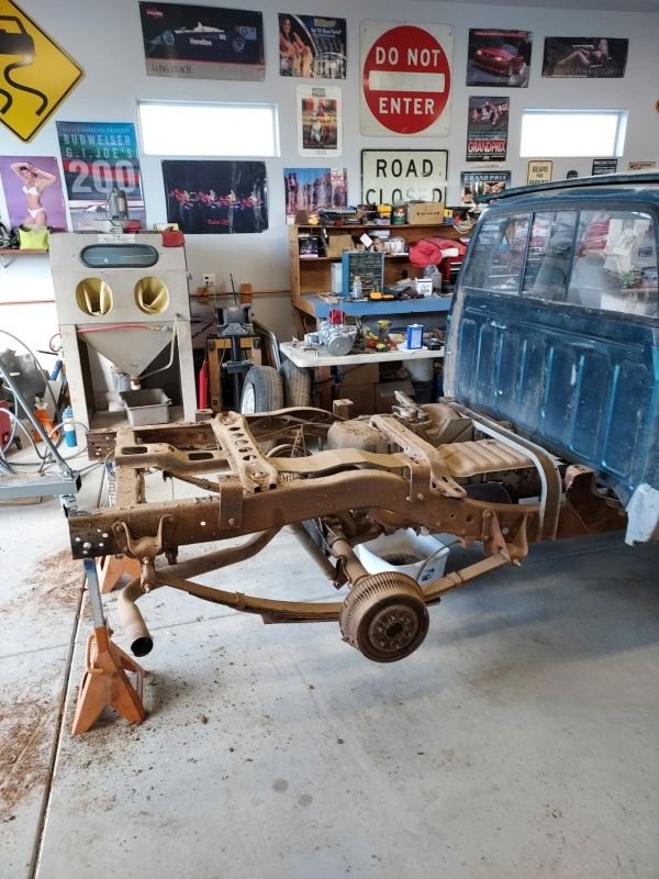

It's been a long fall season. Too much travelling, and then a bad case of the flu. Next step of my project is to pull the bed off the chassis. Finally seeing a break to get some shop time in.

For Christmas activities, pulling the bed off the Dakota came in a close second to opening presents! Only bleeding from one finger, so that's what I call a win!

The radiator and core support did not want to come out. Rusty body bolts are no match for a man with a sawsall! Time to pull the driveshaft, transmission, and motor.
