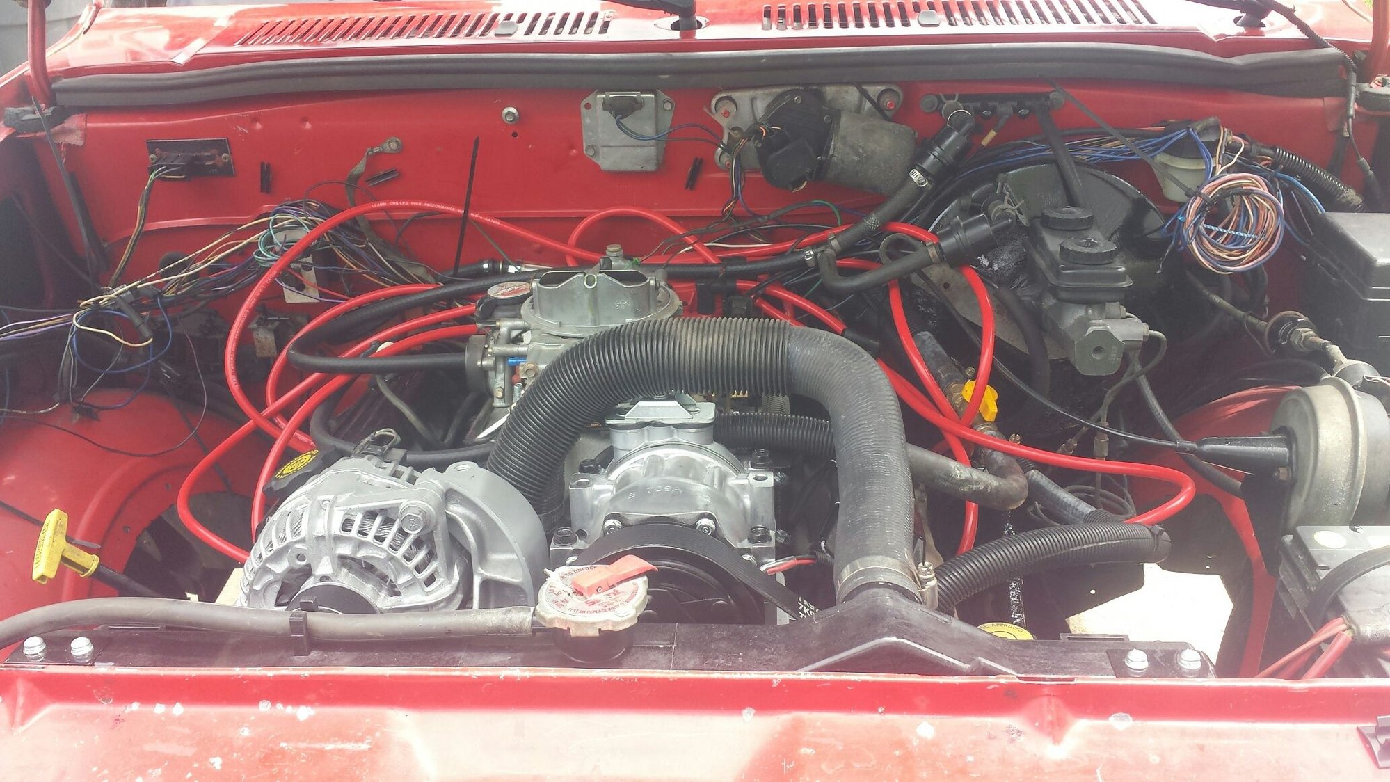

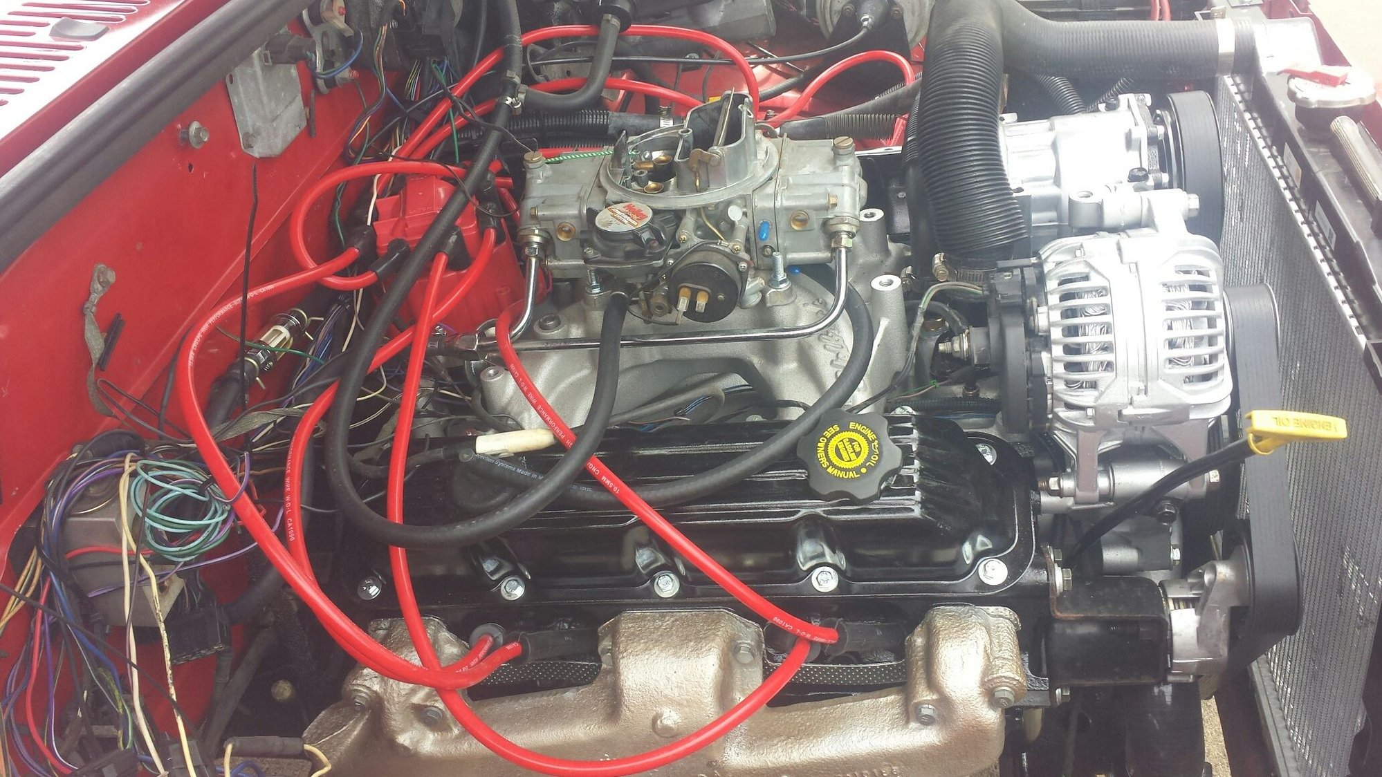

Understood.... The reason I ask is, there seems to be no way to tune the 92-95 (OBD 1) systems with mopar. When I built mine, I used the Edelbrock 7577 intake with a holley carb. FWIW the edelbrock fits and works better with the factory accessory drive that was used on the magnum . The other brands, seem to be set up to use the older LA style accessories.. On these the thermostat housing is offset compared to the edelbrock and factory magnum intake. It causes the thermostat housing to be in conflict with the compressor.
Here is a couple pictures of mine when I was setting it up. Wiring was not completed in these pictures.

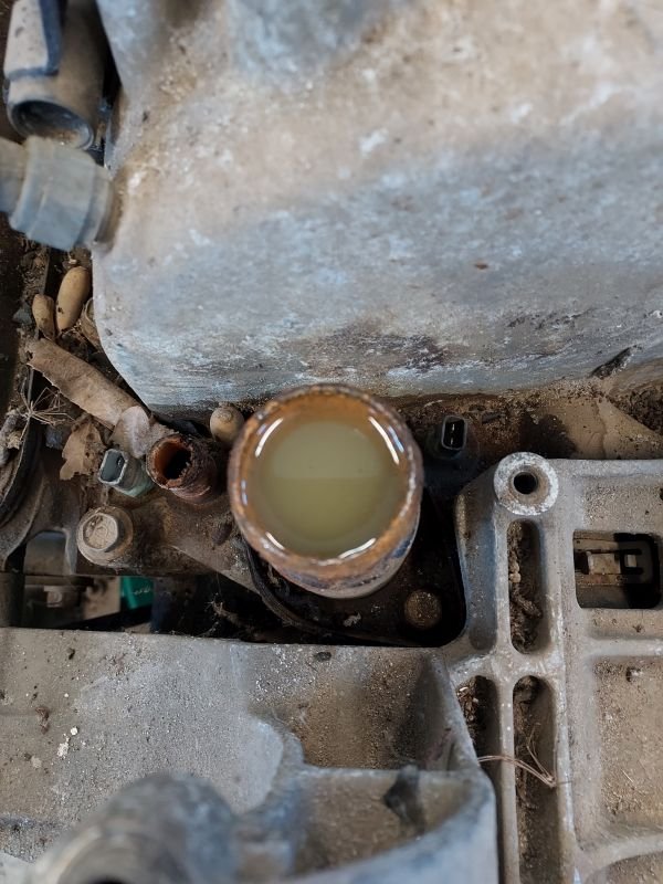

I made it out to the shop this morning, and took a closer look. There is a single wire sensor, and a 2 wire sensor - one on each side of the radiator hose connection.
Old Jan 8, 2023 | 03:14 PM
  #38
Posts: 87,478
Yep, that is correct. That two wire sensor is very well hidden though, especially if the a/c compressor is still there.

Somehow I was picturing them right next to each other. Oh well its been almost ten years since I tore it apart. The FSM says not to pull on the wire to disconnect those sensors. It suggests you make a tool out of coat hanger with a small L bend in it to pull the plugs off those two sensors. They do not lock into position it is just a compression fit.
