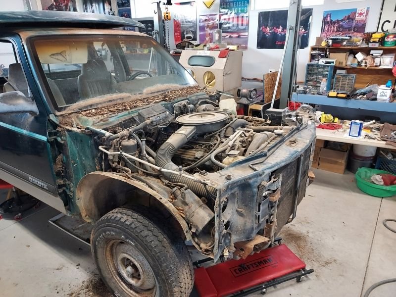

Old Nov 5, 2022 | 07:08 PM
TheSneeze's Avatar
TheSneeze
Joined: Oct 2022
Posts: 668
Likes: 113
Today I started the tear down. This has to be the filthiest vehicle I have worked on. I picked up a Haynes manual to help find hidden fasteners. I am working toward getting the motor out and disassembled so I can take the block to the machine shop. The condition of the block will answer several questions on how I move forward on the heart of this project. I call it a Studefrankenbaker.
