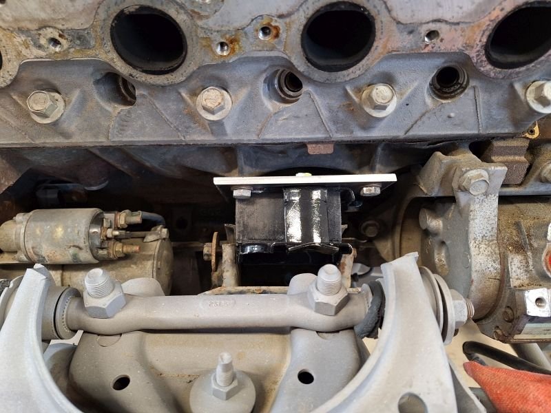

After a day and half of messing about with the motor mount adapter plates, the engine fits! I used 1/4" thick steel plate for the adapter plates. Stock Dodge Dakota engine mounts, bolted to a LS block. The cross member will require another adapter plate. The 4L60E tail cone came up just a little short. I will use the same plate stock and make a plate with 4 holes, and scoot the urethane pad rewards. Four bolts later and the engine/trans mounts are completed.

This LM7 truck motor had the only stock oil pan that clears the front cross member on a Dakota. It hangs around an inch bellow it, though. I am going to lower the front end, so I may need to change it. I not slamming the truck, but I need to prevent anything impacting the oil pan.

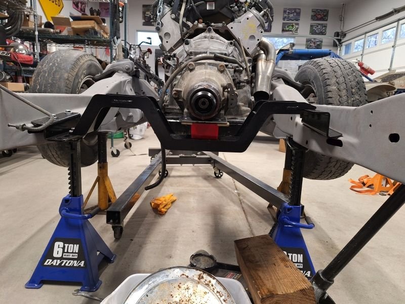

I finished the trans mount adapter plate as well. I just need two high strength bolts and the engine and trans mounts are complete!

The Hooker Blackheart cross member has nice clearance to tuck the exhaust up into. Great product design. I finally have my pinion angle - 6.55 degrees. With that number defined, I can start on the rear suspension while the trans and motor go out for rebuilding.

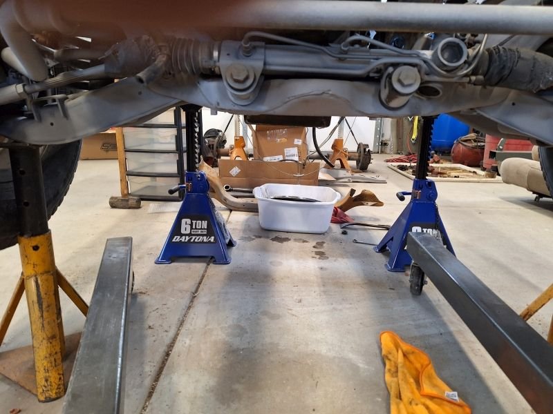

I decided to open the diff on y '98 Explorer rear axle assembly, and see what I got from the junkyard. Sometimes it's a crap shoot on what you get, and what condition it is in. Winner, winner! Chicken dinner! From the tag codes it is a 3.73 gear ratio, limited slip, 8.8" axle assembly. All of the teeth inside are spotless, and nothing in the oil! Time to hack off brackets, and get to welding! Once this rear end and 4 link suspension are in, I will swap out the front rotors for some '90 Dakota 5 bolt ones and ditch the stupid 6 x 114.3 pattern. All four corners will have 5 x 4.5, and I already picked up four used wheels and tires with that pattern to turn the chassis into a roller again.

It's in much better condition than I was expecting, for a 25 yo rear axle assembly. One of the calipers looks like it was replaced as well.
