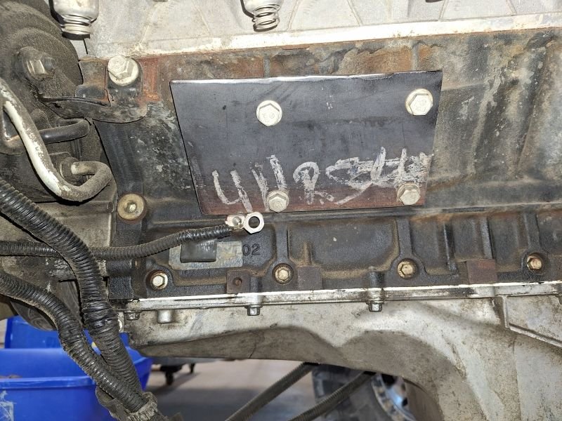

First test fit of the driver's side engine mount adapter plate. I decided to do a test fit before I drilled the other two holes. I also discovered the oil pan is already the correct one that will clear the front cross member. Another part I won't have to buy!

Your oil filter has a pretty significant dent in it.....

Yeah, it was leaning against the pallet on the way home. It will be replaced during the rebuild.

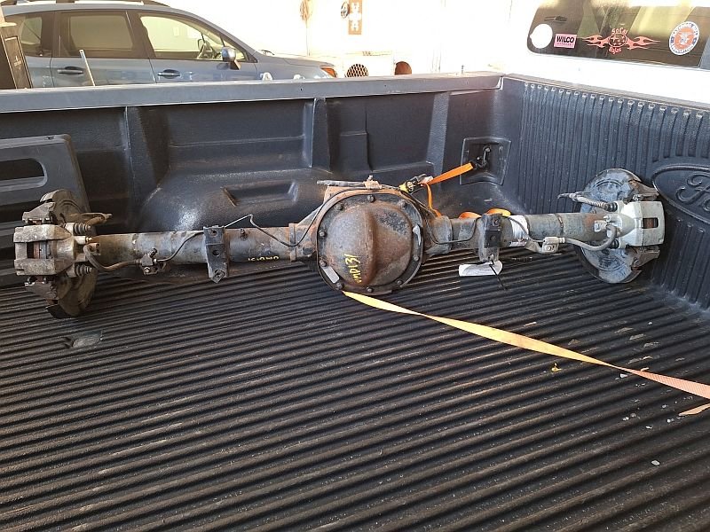

I just scored on a rear axle assembly from a Ford Explorer. It an 8.8" with 3.73 gear ratio. I ended up paying less money than it was going to take to convert my Dodge 8.25" rear axle to 5 lug and a locker. I am still on the hunt for a transmission. The core charges on transmissions are all over the map. I seen the core charges ran from $150 up to $455 in some places.

Since I was gone last week for the holiday, I just got the rear axle assembly picked up.

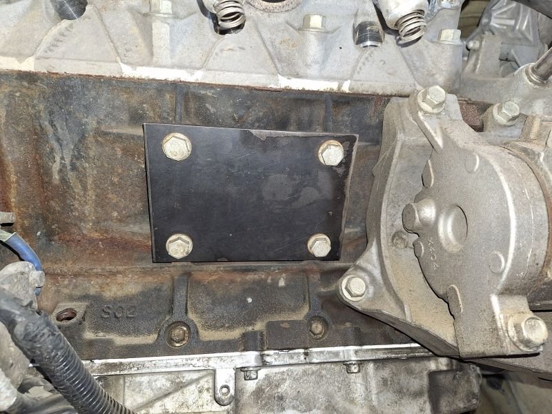

I finished up my motor mount adapter plates today, in anticipation of the transmission arriving. Once the trans is bolted up to the engine, I can test fit it in the chassis and scribe my motor mount hole locations. The driver's side adapter is longer to compensate for the mount offset in the chassis.
