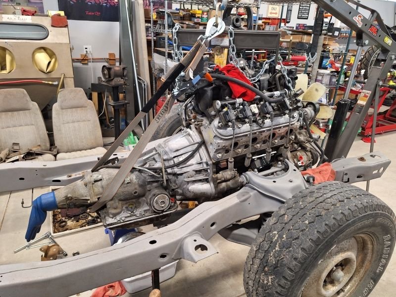

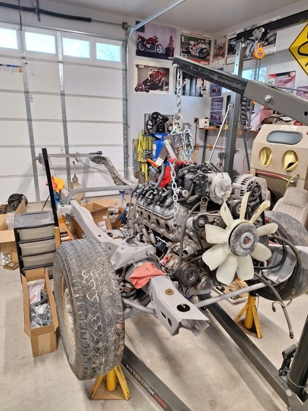

TheSneeze
Joined: Oct 2022
Posts: 668
Likes: 113
The nugget has landed! Well, for the first time, anyway. It is sitting on the motor mounts, but I still need to put in the cross member. Time to mark the mount holes on the driver's side adapter plate, then it comes out to finish them.

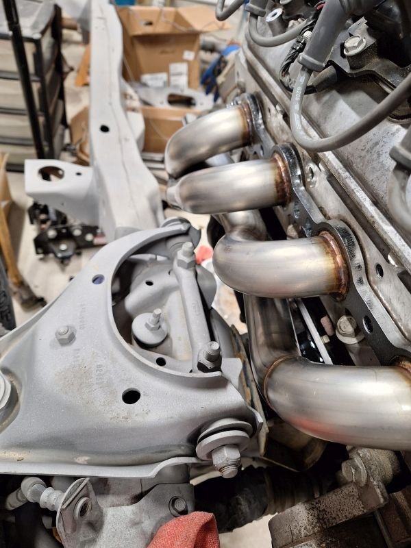

TheSneeze
Joined: Oct 2022
Posts: 668
Likes: 113
The passenger header is a tight fit, but it clears everything. Much more room on the driver's side. There's nothing quite like a set of tight fitting headers!
Old Dec 4, 2023 | 08:37 PM
  #188
Posts: 87,482
Holy smokes, is the engine really offset that much??? There is a boatload of room on the drivers side, and 'barely clears' on the other.

TheSneeze
Joined: Oct 2022
Posts: 668
Likes: 113
Yes, the drivetrain is offset that much. So is the Dakota rear axle assembly. Luckily, the Ford 8.8" rear axle assembly is offset as well. From what I have heard, most American made cars have the drivetrain offset to some degree.
