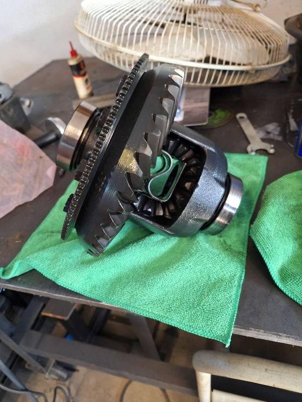

I have been watching a bunch of youtube videos on how to rebuild a Ford 8.8 rear diff. Stepping out of my comfort zone as I have never done a differential before. I thought I was prepared after buying all new seals, bearings, pinion nut, crush washer, special oil resistant high heat silicone, e-brake parts, and caliper pads. After seeing what it takes to set the back lash and pinion preload on the videos, back to the interwebs for shim kits, diff paint (for gear teeth), special tools... sheesh! The whole process doesn't seem that intimidating mechanically, but the trial and error in getting the gear alignment looks like you could get lucky, or spend all day putting it in and taking it back out again, trying shim stack after shim stack. At least when I am done I can check this process off my never done that list.
Axles are out and the diff is on the bench

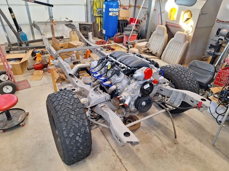

I put the front roller wheels on, and re-leveled the chassis. These roller wheels will never see the street - they are only to move the chassis around after the rear suspension is done. My diff shims won't ship for several more weeks, so the plan is to start boxing in the rear frame rails in preparation for the four link suspension brackets. I got 2" lowering springs and shocks for the front from Belltech, but those will go on after the rear is done.

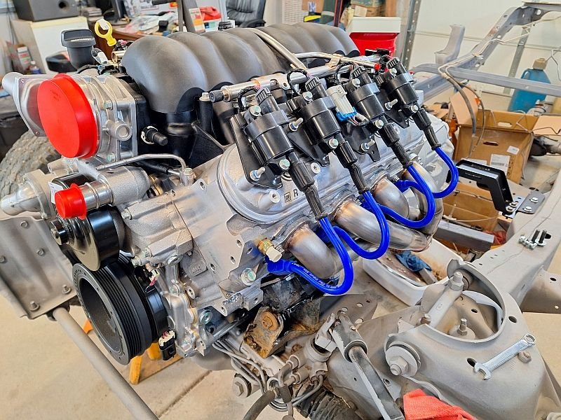

Speaking of expensive, I had a near heart attack when I started to check out the accessory drive kits for these LS motors! What I like vs. what I want to spend are pretty far apart at this point. Want - Holley mid mount accessory drive, $2300. I was hoping to spend half of that. Since it will be awhile for the cab to go on, this can wait for the future. This is the Holley mid mount kit. Very compact layout!

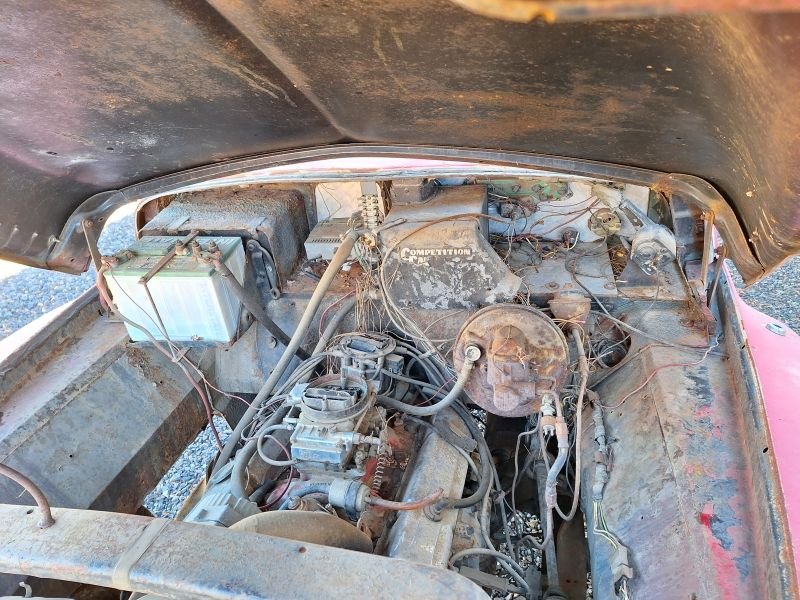

The "connect and cruise" crate drivetrain does not come with the accessory drive. You have to provide that on your own. It came with the water pump and pulley, and the harmonic balancer - nothing else on the front of the motor. It is probably intended for customers to swap their existing accessories onto it, but I do not have any existing accessories. The Studebaker truck has a SBC in it, but it was sitting under a tree in southern Washington state for 15 years, What is there it pretty ratty looking, and the mounting brackets are not designed for an LS engine.

Here is the current engine bay of the Studebaker. Like I mentioned, 15 years under a tree in southern Washington state didn't do it any good! Not a very dry environment to store a vehicle.

Looks like there is plenty of room there for the stock bracketry and such. I actually like the 'high and wide' as it makes things easier to work on when necessary.
