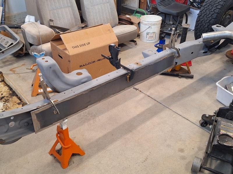

Today I started cutting my plates to box in the frame. I won't be doing the entire frame, stopping just behind the rear axle, and in front of the where the fuel tank will mount. If you ever weld using hot rolled plate steel, remember to grind away the scale well away from the HAZ (heat affected zone). Always clean BOTH sides of your base materials and the parts you are joining to them. I see so many "garage welders" welding dirty and or rusty parts together with zero prep. Rust is iron oxide! The key being oxide (contains oxygen), and it will contaminate your welds. It may appear smooth on the outside, but it will Swiss cheese inside and very weak. The rusty areas on the frame will be wire wheeled clean after the final test fit of these panels. Okay, stepping off my soapbox on welding prep! Here are the first two plates ready to test fit, and the first one clamped in place. Some trimming will be needed before I can start to tack them in place. The frame has been leveled in both axis, and there are two cross stock cross members that bolt in that will be put back in before tacking as well. I am not looking forward to welding on my back!

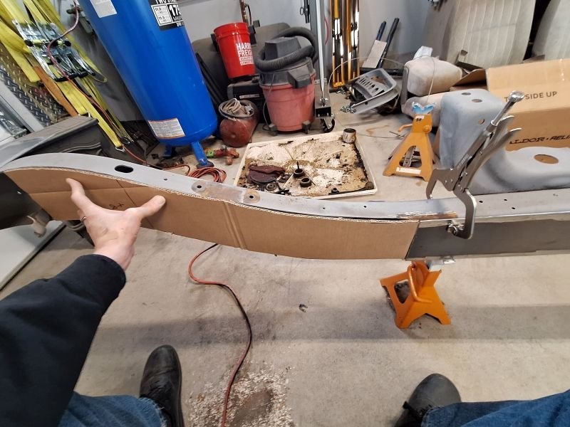

More cutting cardboard, grinding, and fitting today. The curved plates need more fitting before I am happy with them.
This transition is a bit funky. This is where some grinding/fitting will be needed. That whoopsie with the cut off wheel will get ground out and welded in.
These curved sections will need some rubbing before the fit meets my expectations. There is always some fit issues transferring cardboard to steel. The steel plate is just resting there, it is not home yet.

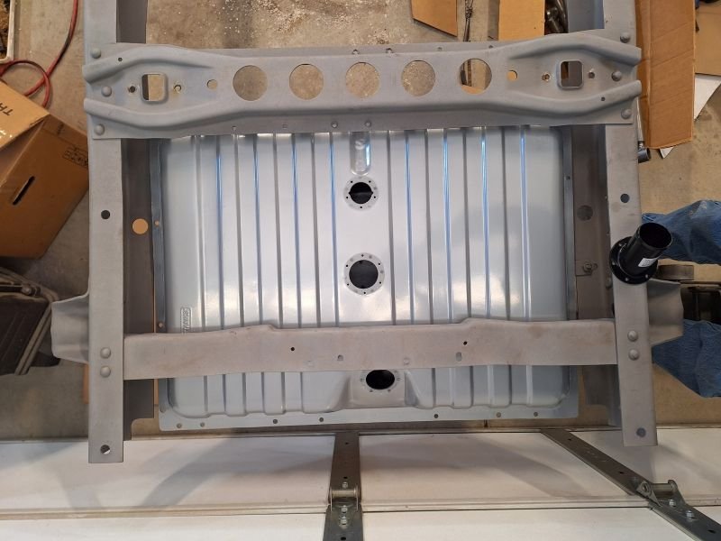

Feeling a little bored today. I can't do much with the temps this cold, so I decided to see how well I measured when buying my new fuel tank. It looks like it will squeeze in there just fine! This is from Tanksinc.com, and it is meant for a '70 Mustang or Cougar, but has an increased capacity due to more depth. It holds 22 gallons. I will use some flat bar welded to the bottom horizontal of the frame rails. Install some nutserts, and bolt it in from the bottom (allowing the tank to be removed by lowering out the bottom). That's the current plan, anyway! I am thinking the formed upper shock mount brace may need to be relocated farther forward, but that will be determined once the four link suspension and rear end are in.

Wow, that hangs down pretty low...... Don't want that feller hitting the ground over bumps....
