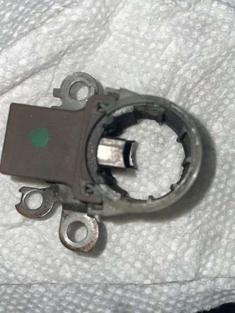

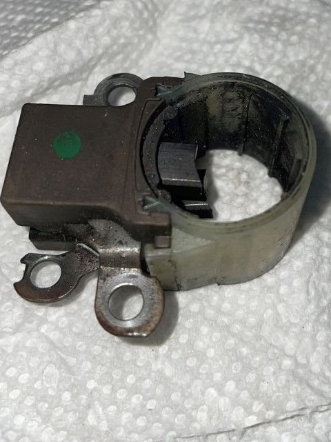

Old Aug 19, 2023 | 11:59 AM
  #175
bronze's Avatar
bronze
Joined: Nov 2015
Posts: 2,232
Likes: 473
From: North Carolina
Not sure how well you can see this but the bottom brush extends a good .150 of an inch further than the top brush. I'm no electrician and I'm no motor man and I'm not even the Fuller brush man but this can't be right.

Old Aug 19, 2023 | 02:18 PM
  #176
onemore94dak's Avatar
onemore94dak
Joined: Sep 2013
Posts: 2,724
Likes: 153
IDK how that part is put together. I would assume each brush has its own spring. It could be as simple as one spring being stronger. I think your suspicion might be correct. If it aint borked....
