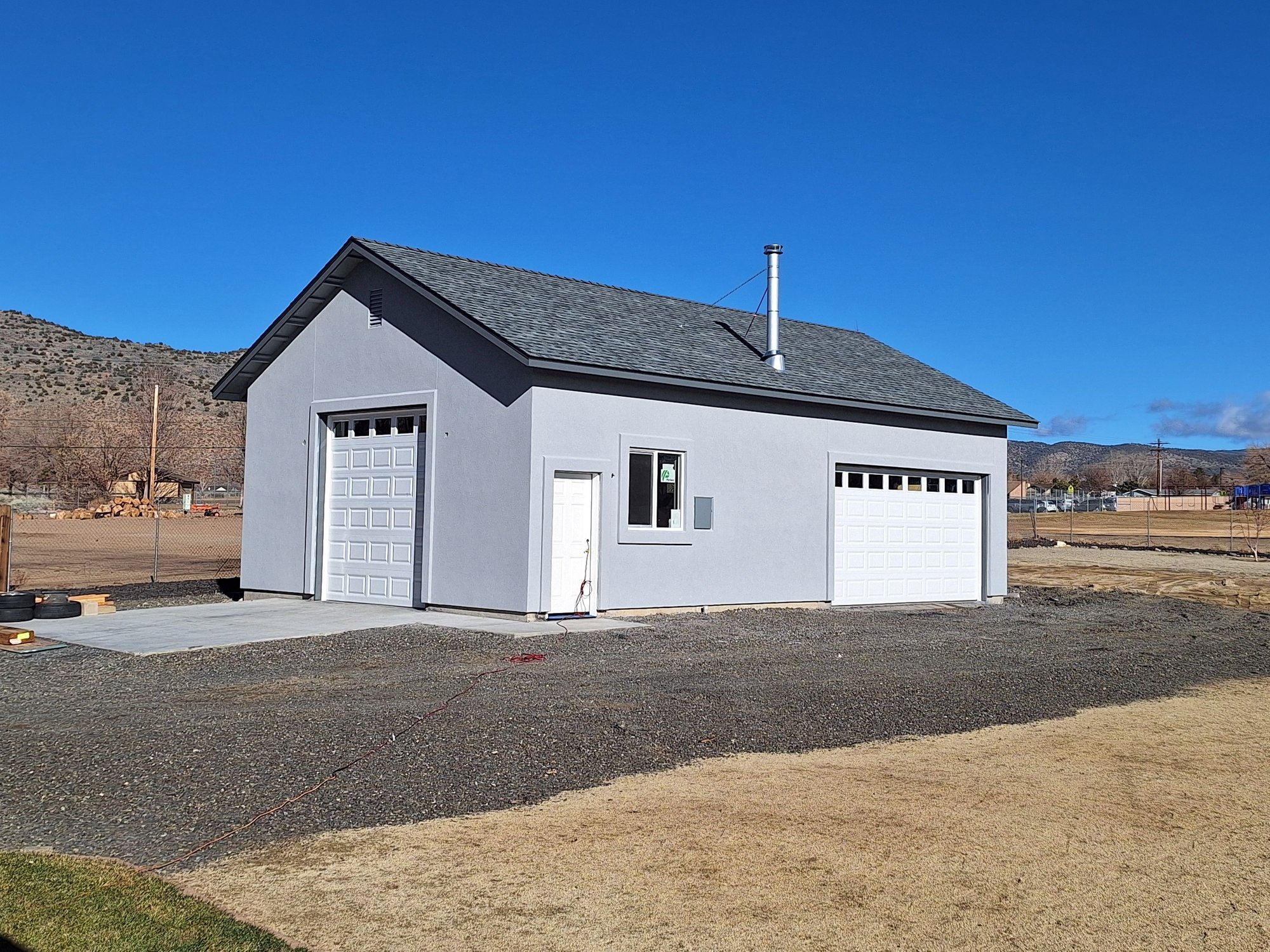

Paint the trim, install the lights, and the exterior will be finished!

Lookin' like a real garage again. Is it warm enough to paint???

We will need to heat the interior for the mud to be applied. Daytime temps in the shop are 50-52 F.

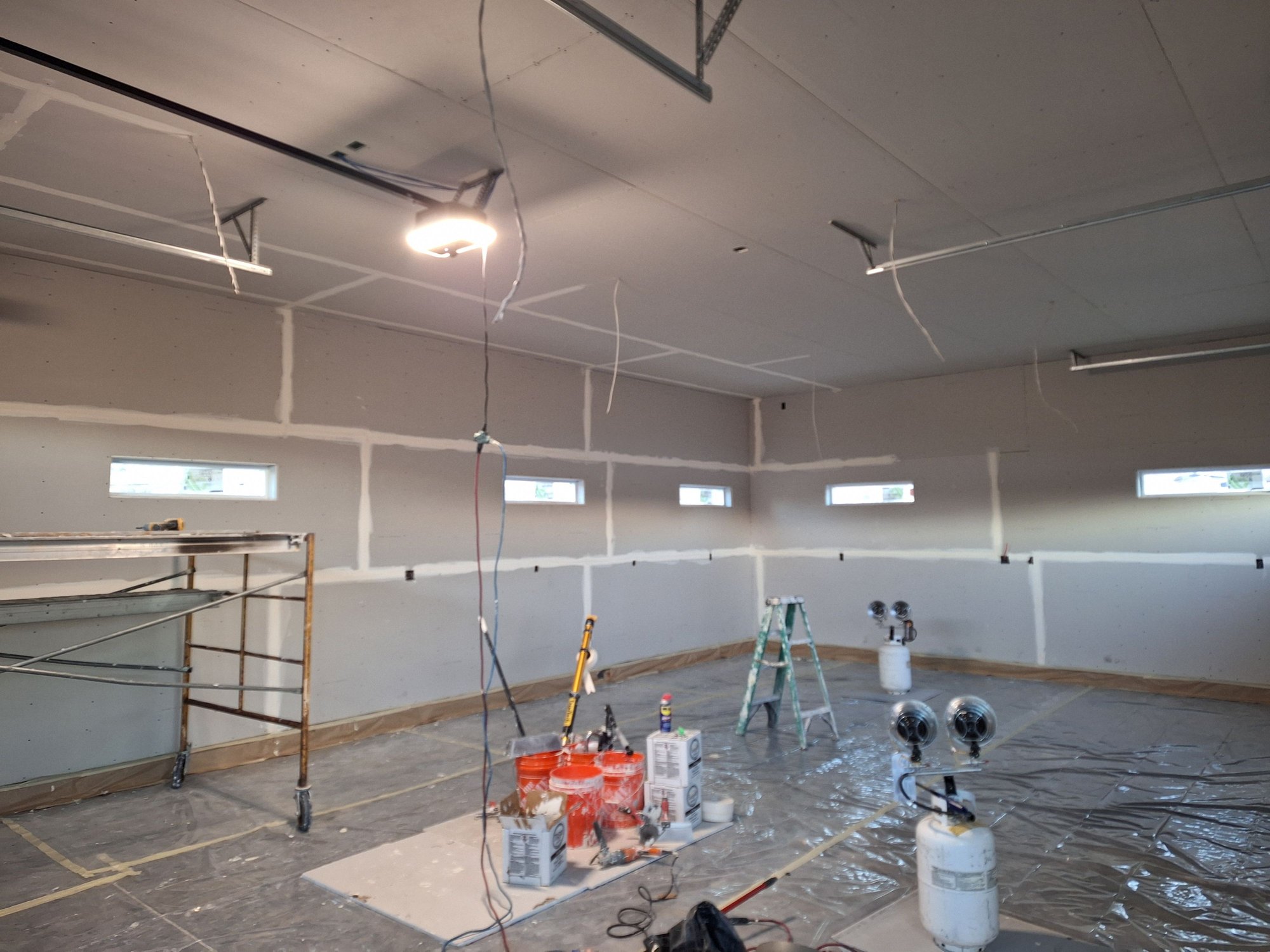

So, it was 18 degrees this morning at sunrise. Inside the shop it was 48 degrees. Six inch thick walls and full insulation really make a difference! The tape and mud has begun, with two heaters running in the shop and a fan going. I should see the texture and paint by the end of next week. The doors and window are cracked open for ventilation. I will leave one of the two heaters on low overnight hooked up to a 7.5 gallon tank, and see how it works. The heaters are mounted to the top of the tanks, and the tanks are each on a piece of concrete backer board, and at least six feet away from a wall.

Don't charge any lithium batteries in there.......

YA THINK??!!!
The heaters work well, but tonight will be a test. I intend on putting one one low around 10 pm, and let it run until morning. It's supposed to get down to 21 degrees tonight. It looks to be a little more than 50% complete on the taping so far.

How long will those heaters run on a tank??

I had one heater run all night on low. I haven't checked the propane level yet, but it was 63 inside the shop this morning. 21 degrees outside.
*Edit* The heater burned around 4 gallons of propane overnight. Those tanks hold 7.5 gallons each.

Wow, that's not too bad..... and the temp is outstanding......
