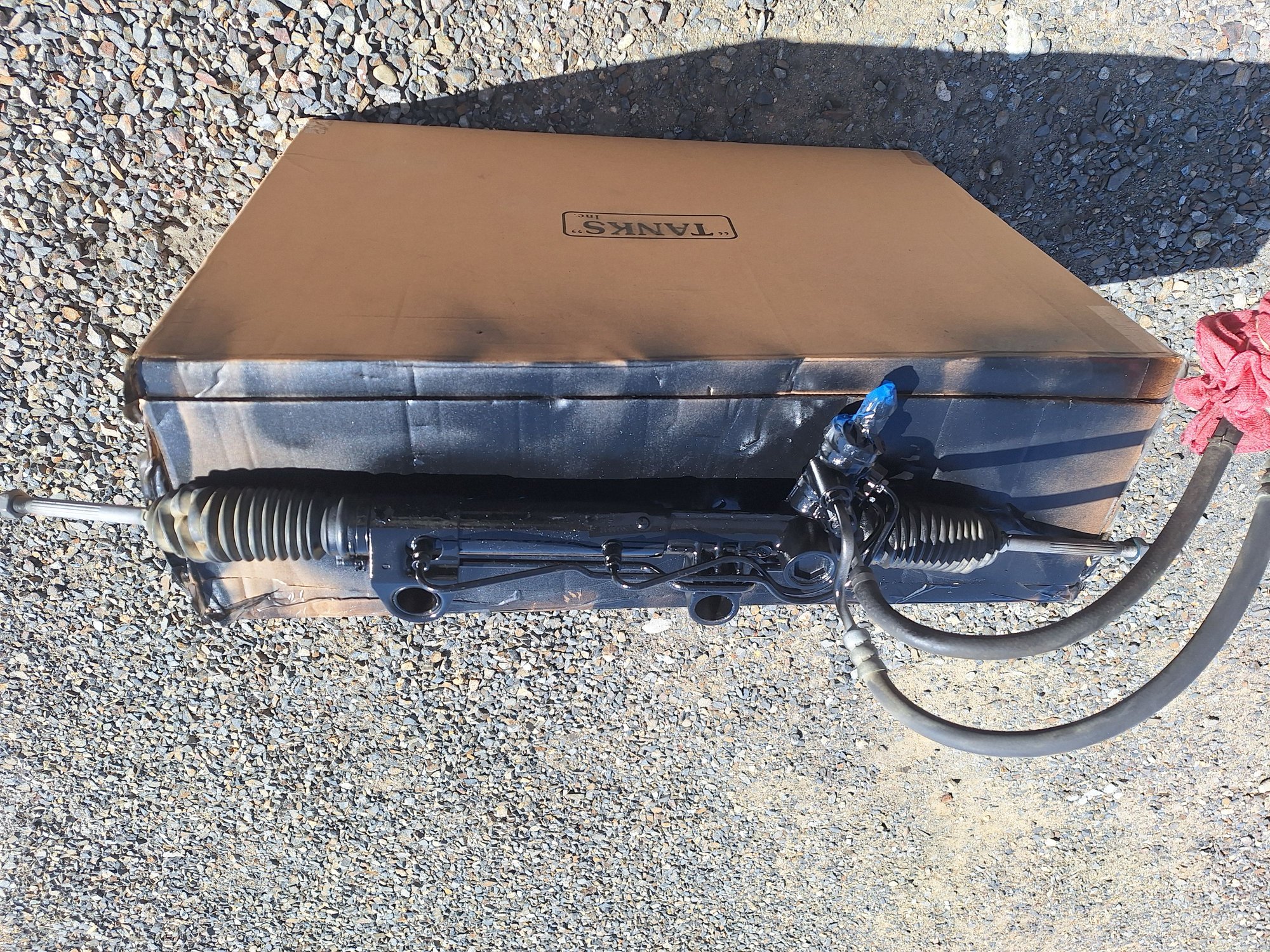

Likes: 113
The rack and pinion are getting some love. New bellows, fresh paint, and new outer tie rod ends.

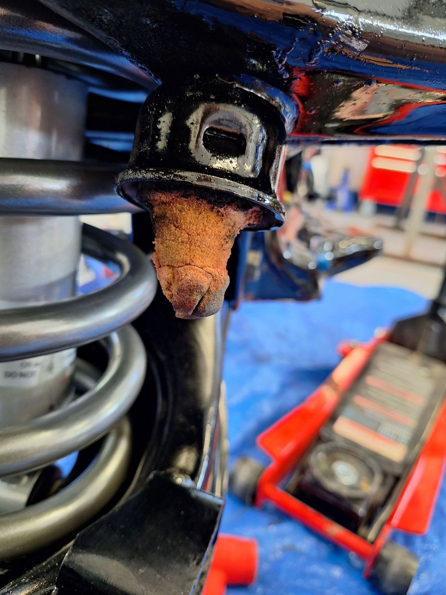

Likes: 113
I finally got the shocks in. It took grinding the hole larger on the lower arms (just enough to tap them through). The next item up I need some helpful suggestions. I bought new upper bump stops. The problem is the originals are completely rotted, and crumble against any force. The new ones have a smooth hole, which tells me these may be glued onto a smooth shaft from the factory. The cups welded to the frame also have some indentations that look like the help keep them in place as well. I have a feeling it will take multiple fresh box knife blades to just cut them out piece by piece.
