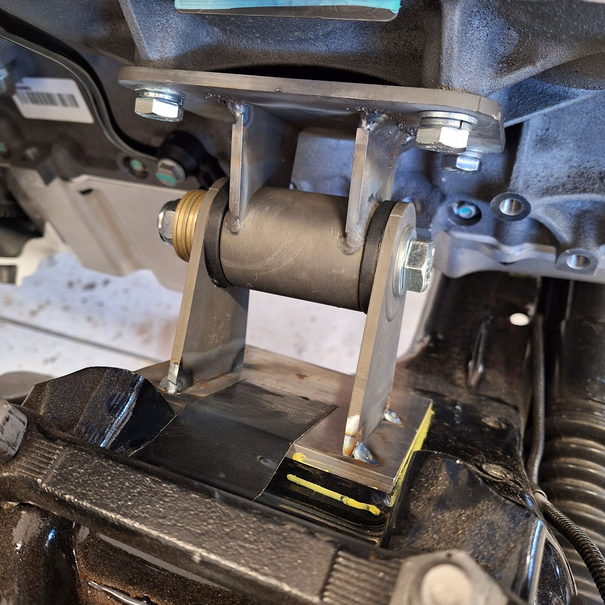

The passenger side engine mount is tacked together, and ready to move to the weld table. The driver's side will be a little more involved. I have to put my engineer's hat on for that side.

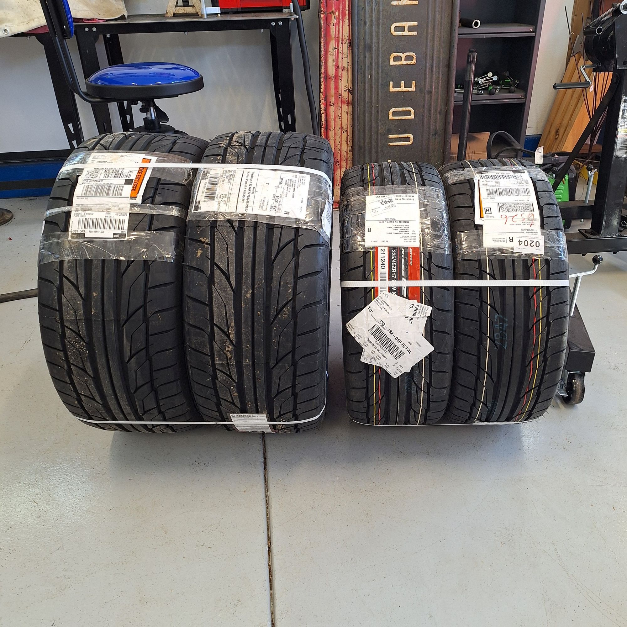

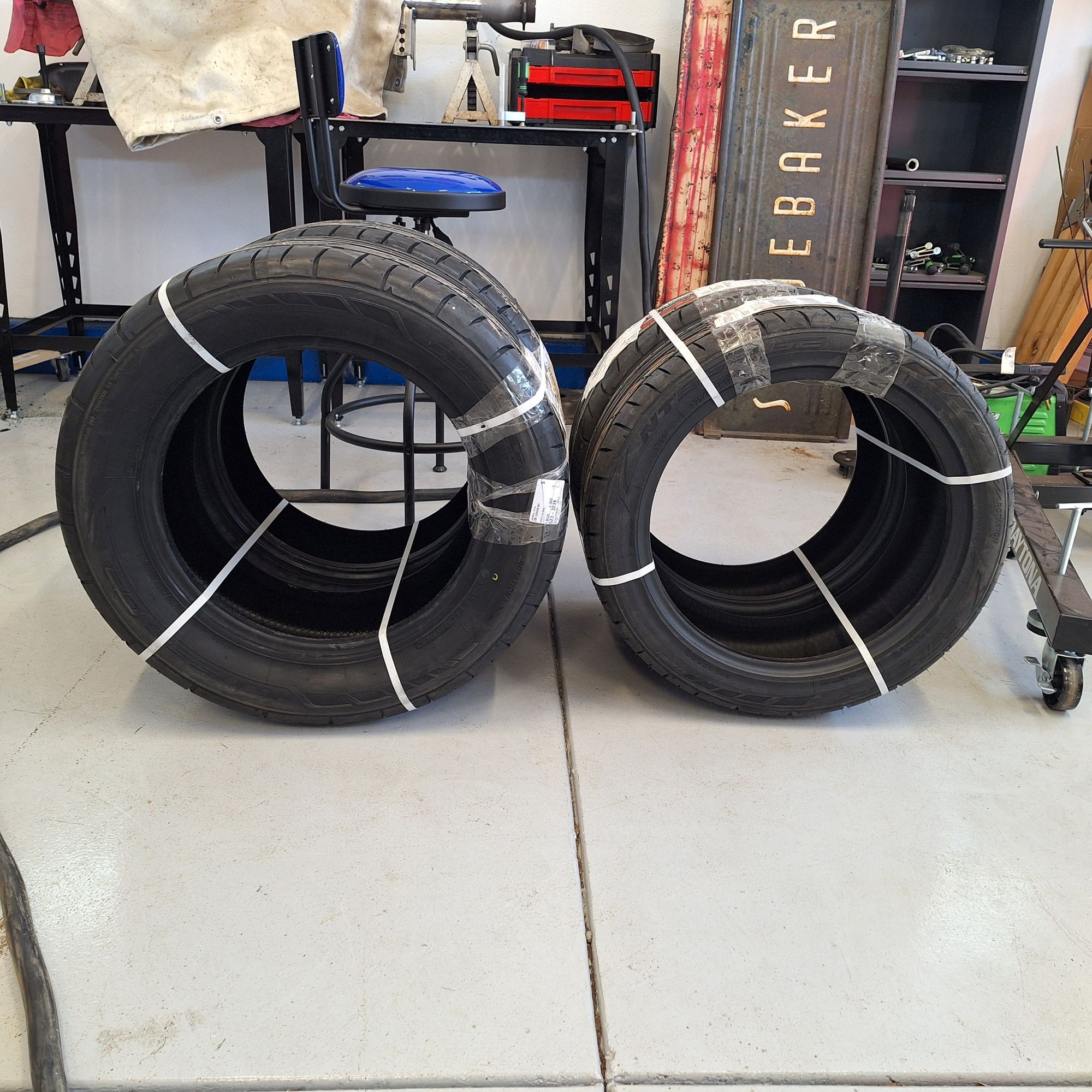

I received the new tires. I just need the new front rims to show up, and they will get mounted and balanced. Both are 17" diameter, the fronts are 225/45R17, and the rears are 275/50R17. The size difference will add to the rake. I can't wait to see what the truck looks like sitting on all four new wheels!
