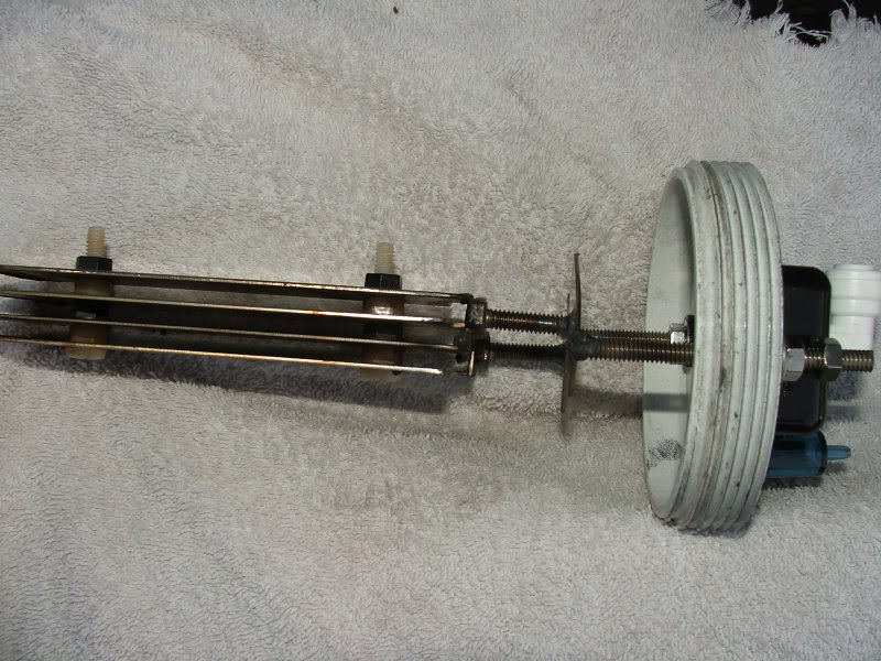

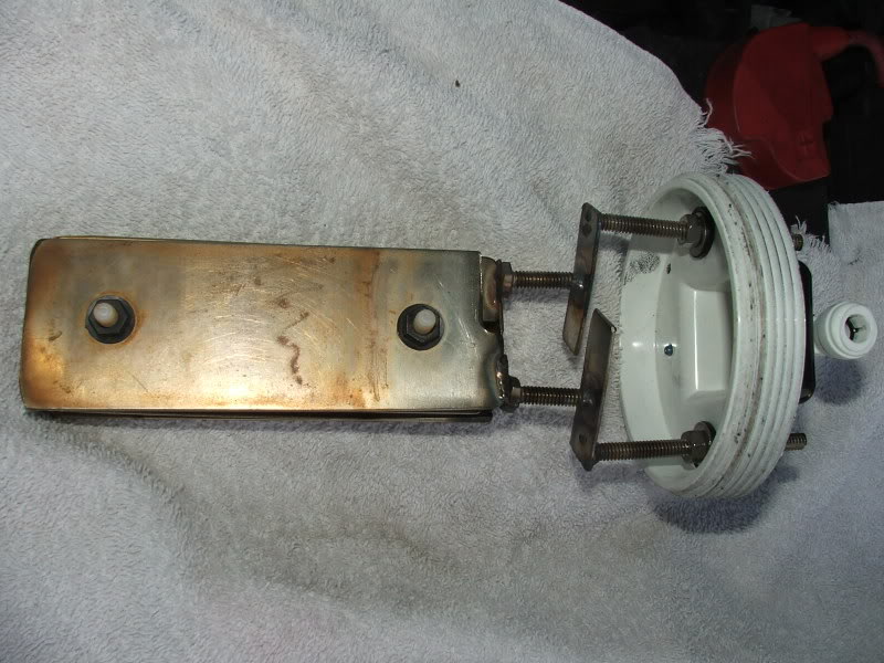

here is the internal of the hho generatorName:  DSCF6476.jpg

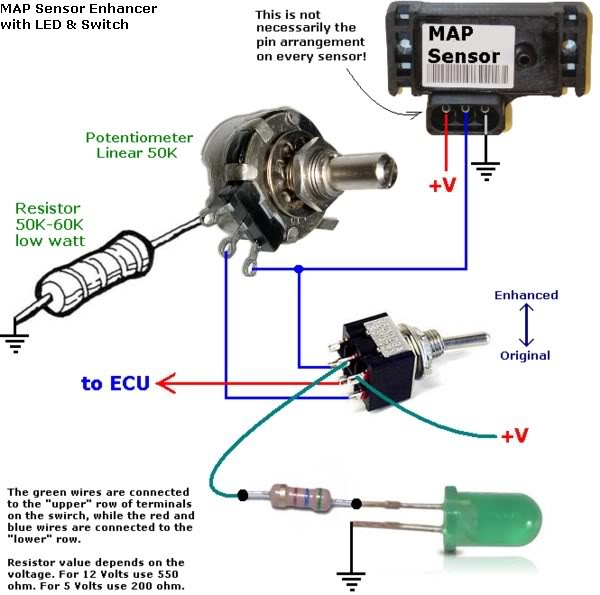

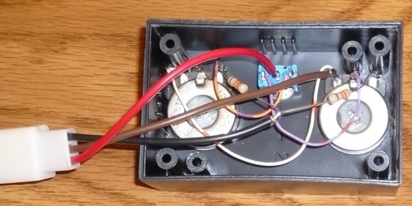

It only cost's about $20.00 to build the map enhancer... here is the diagrams..

My map sensor setup which is the same only one lin pot cost me 3 bucks. The map sensor enhancer can also be used to lower the voltage in your water cells folks. It only takes less than 2 volts to produce hydrogen the rest goes to heating the water, thus evaporating the water fast. Wasting your time.
