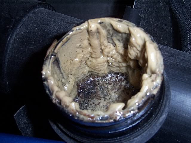

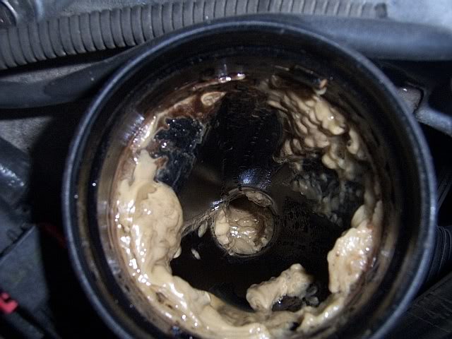

Here are a few snot photos of the snot (NOTE: not Sludge!) problem on the earlier 4.7s and the TSB to fix it.
Service Bulletin Number: 090100A
CUSTOMER MAY COMPLAIN OF AN OIL EMULSION ACCUMULATION INSIDE THE ENGINE OIL FILL HOUSING
Need to install the following 2 parts
53032126AA Baffle, Oil Fill Housing
53032389AD Cap, Oil Fill Housing
Recommend replacement of the PCV valve as well.

I replaced my pcv. Where do you think I can get the 53032126AA Baffle, Oil Fill Housing
Thanks

go to the dealer, but print out the tsb before you go and take it with you, then you will have the part numbers ect
