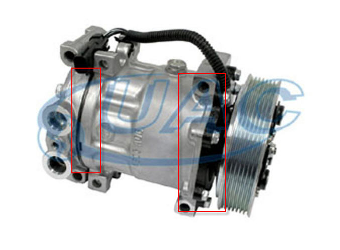

Hey ya'll I'm venturing in the new world of DIY AC repair.. I have a 98 Durango, 190k miles 2nd AC compressor put in around 120k miles. Before I knew better I used 2 of those little recharge canisters of R134a over the last 8 months as on hot days my AC was not cooling... Well finally it's not cooling at all. I got some gages and tried to pull a vacuum. I can only get it to about 12 HG (not the 27-28 it should be) and as soon as i close off the gages the pressure go back to 0 in about 5 minutes... Major leak I know! So, I had dye in the system however I was never able to see any leaks with a uv light. Until tonight... I looked closer and I can see residue, almost a shading of UV colored dye all around both end caps of the compressor, where there seems to be seam/gasket. I thought I would be looking for a bright big splotch, not so much a subtle shading,
So my question, which might be obvious... there should be no dye around the compressor correct? Any dye would indicate a leak and therefore a compressor would need to be replaced?

No there shouldn't be any leaks or dye. When you say end caps are you talking about the connection between the a/c lines and compressor. If so there is an o-ring and gasket kit that you can replace there.
Thanks for the reply! yes its not the o-rings that are leaking I think. Its the sections as pictured below, both ends of the compressor...

that would be indicative of a bad compressor

i tend to agree, leaks in those areas would mean the compressor seals are bad and the compressor needs to be replaced.
