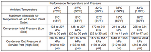

im not sure if the 2000 had the new style two zone system or the old style, but the 01-03 trucks required 2.44 lbs of refigerant for the dual zone system as per the attached sticker off my radiator mount
