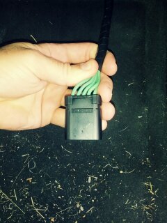

lets try this again - from the computer and not phone ...
Attached Thumbnails Blower Motor Resistor - Constant burn-outs-13728057685790.jpg   Blower Motor Resistor - Constant burn-outs-13728057923540.jpg   Blower Motor Resistor - Constant burn-outs-13728058066400.jpg

Looks like it worked - hard to see inside the plug with the size of the image - but the plug is melted badly like the inside of the resistor.

That is the exact same plug, and the Resistor is burning on the exact same two prongs, and from what I could determine, those two leads feed the Blower Motor. The last time out I swapped out the Blower Motor, replaced the Plug, and Resistor, so far, no more problems. Once the Plug is damaged by an overload, such as the Blower Motor drawing too much current, if you don't replace the damaged Plug (or Connector if you prefer to call it that), and the Resistor all at the same time, the resistance caused by the burned connections, will fry the Plug and even a new Resistor. The Plug is available through NAPA, or a Online place called Parts Geek, and is Standard Motor Products #S-1768, the Resistor is Standard Motor Products #RU-380, and the Blower Motor is Four Seasons Part #75740. Don't try sourcing these parts used, they may already be failing, and you'll only find out after it all fries again.

1 more question, I already have another resistor. Will the plug you have listed fit the stock resistor? It just looks from the pic, a bit different?
