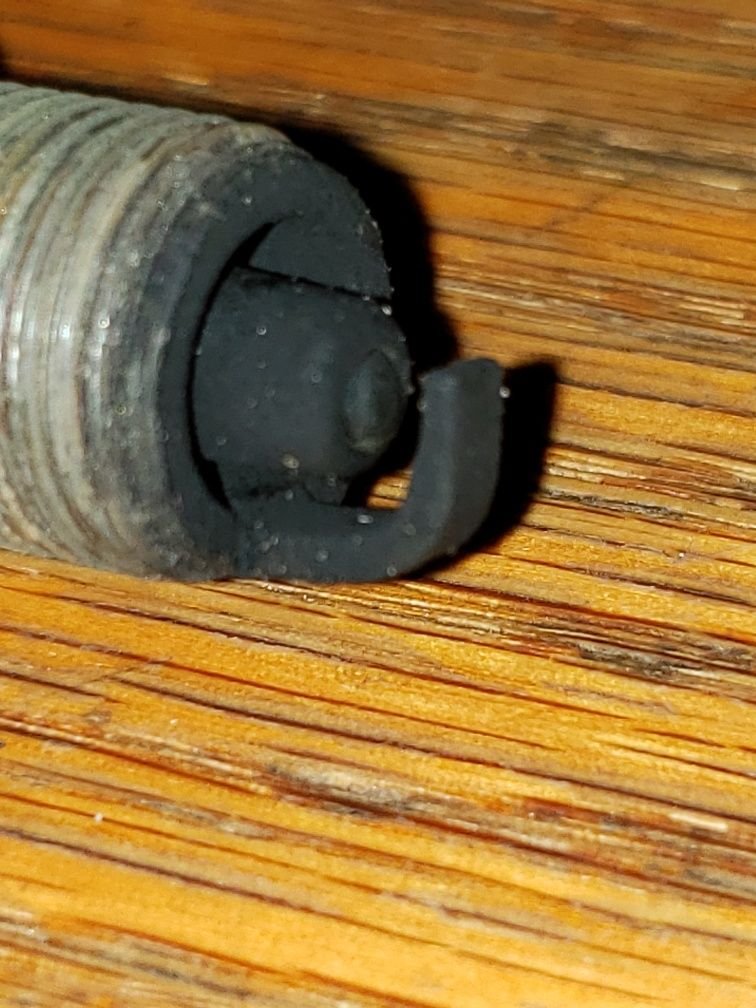

I know the new spark plugs are making a WORLD of difference as I was getting a TON of crap out of the exhaust pipe:
This was #8 cylinder's plug....most of them looked like this....Yes I know I should have changed them long before now, I picked the beast up with 230k on the odometer and it had been running smoothly...(still getting 14-16 mpg ) and I am finally physically able to work on cars again...
