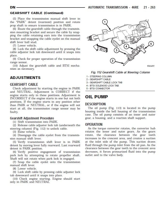

When you said that you got the shift cable as close into adjustment, how close did it get? Could it be that the cable is not fully "locked in"? I snipped the adjustment section from the manual on the 46re for ya. Sounds like it might be a tad off and keeps popping into neutral...wouldn't hurt to check the adjustment again.
