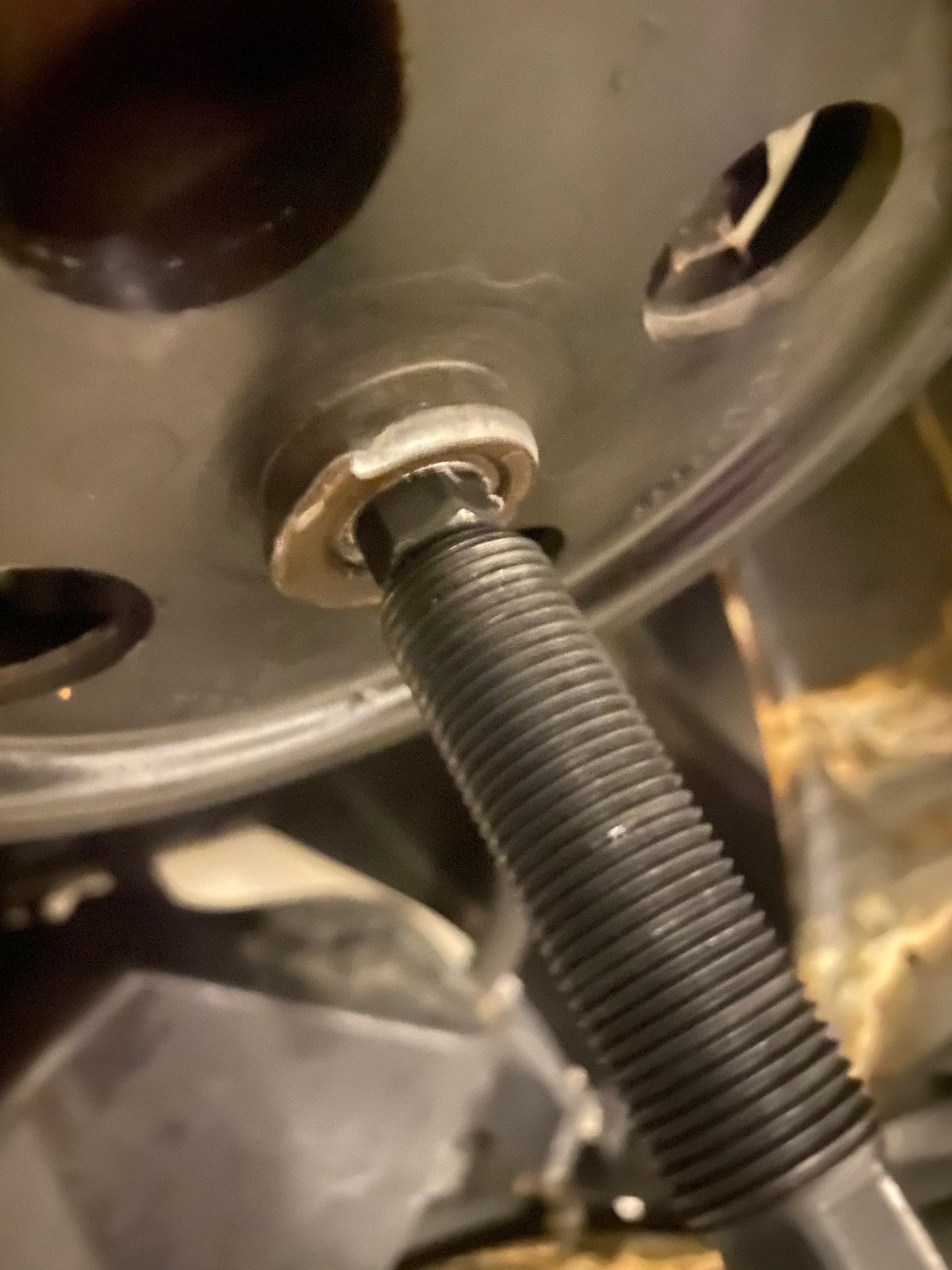

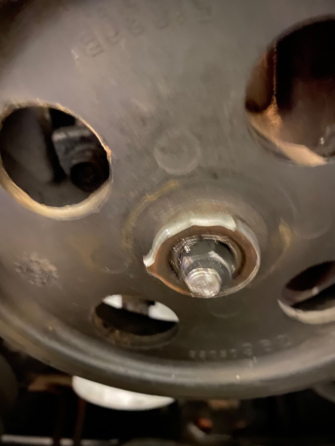

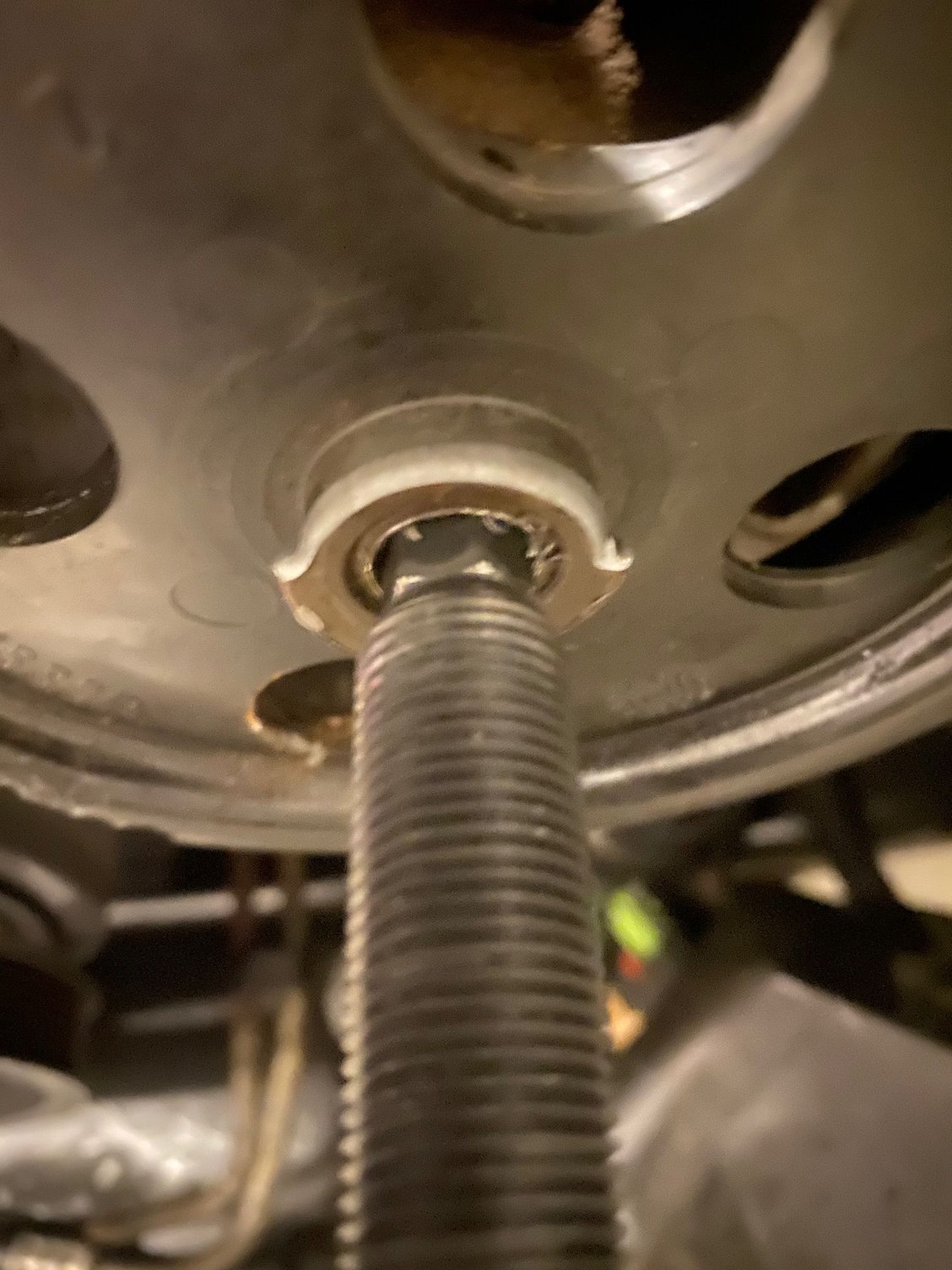

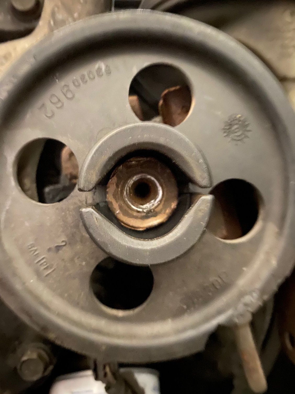

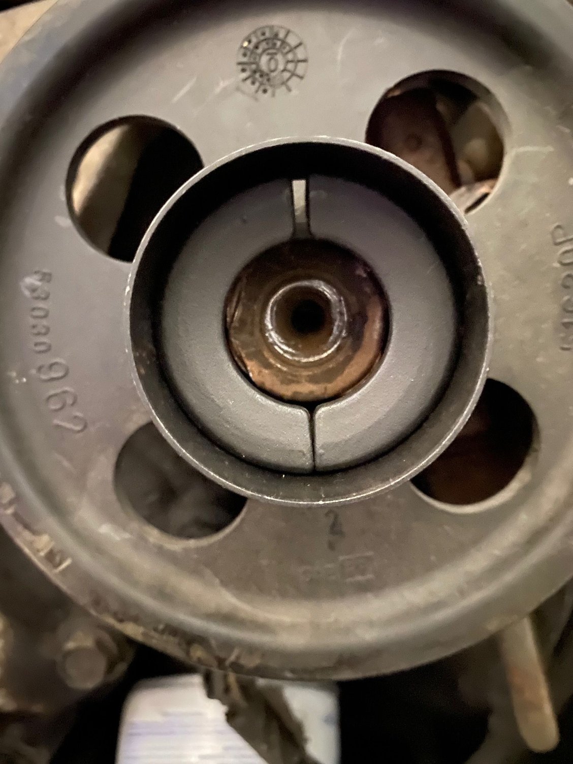

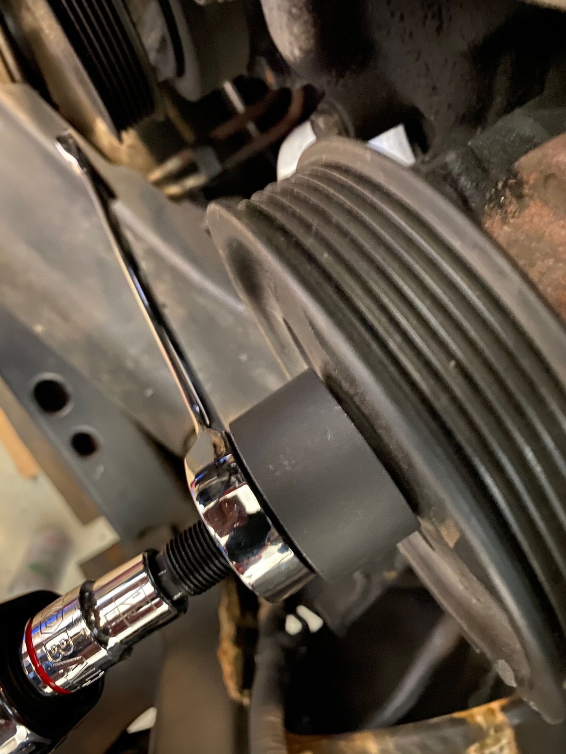

That said, setback with the power steering pulley today. Got the proper tool with the metal halves and collar and installed it. I do not have an impact wrench and knew elbow grease would be required with my ratchet and wrench.
After installing the tool, and getting to the point of toughest friction, when the pulley should begin to pull back, the half pieces are actually somehow winning the war and finding their way OVER the lip of the darn pulley! Pictures ahead. I assume I have this on correctly. I saw in one youtube video that someone actually had to get a metal hose clamp and place it around the collar to succeed. Which means the tool itself is not doing what it is supposed to do. So it has to be one of these:
1. operator error - I've installed the pulley remover or am using it incorrectly
2. need an impact wrench to shock it into submission, hand tools will not be sufficient
3. need to somehow further tighten the collar to prevent it from slipping off the pulley wheels notches (still amazed it's doing this).
Photos ahead, one way you can see the gap is so large I can't get the collar around, the other way the collar goes on almost too easily, I have seen lots of grumbling on forums of people with this process, maybe I just need to take a break and figure out what is wrong here. My guess is that it's #3 and the pulley puller is not tight enough around the inside lip of the pulley to be grabbing and that's why it's slipping, but it's also possible I missed a piece or a step with the puller that is causing it to not hold flush. Thoughts on my incompetence are welcome.
First photo shows when the tool is starting to slip away, second and third show the two ways to put the half circles around the pulley (first way too much of a gap to get the collar on, second way it's almost too loose and the reason it slips I assume).

Looks right to me.... It's a pretty tight press fit. Even with an impact, they really aren't thrilled about coming off.

Look at the ends of the 1/2 pieces. The ends are 2 different diameters, if you need the smaller one (bigger lip) and you use the ends with the small lip it might do that.
try the ends with the thicker lip (use both of the same side against the pulley) If the sleeve doesn't slide over the halves like that (spread too far for sleeve to slide on) then that's not it. Could just be a "cheap" version of that tool. AKA Junk

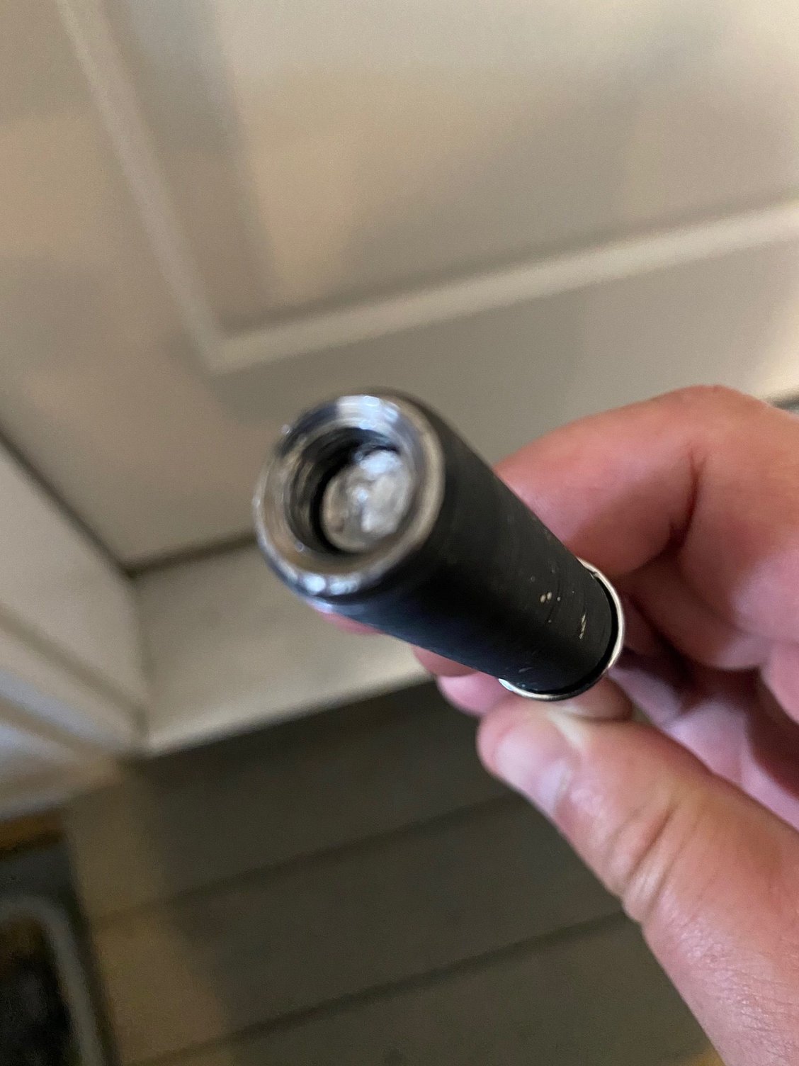

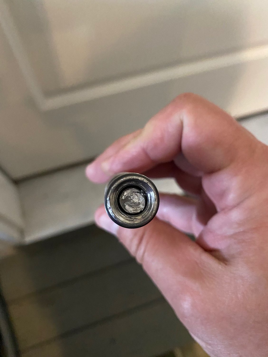

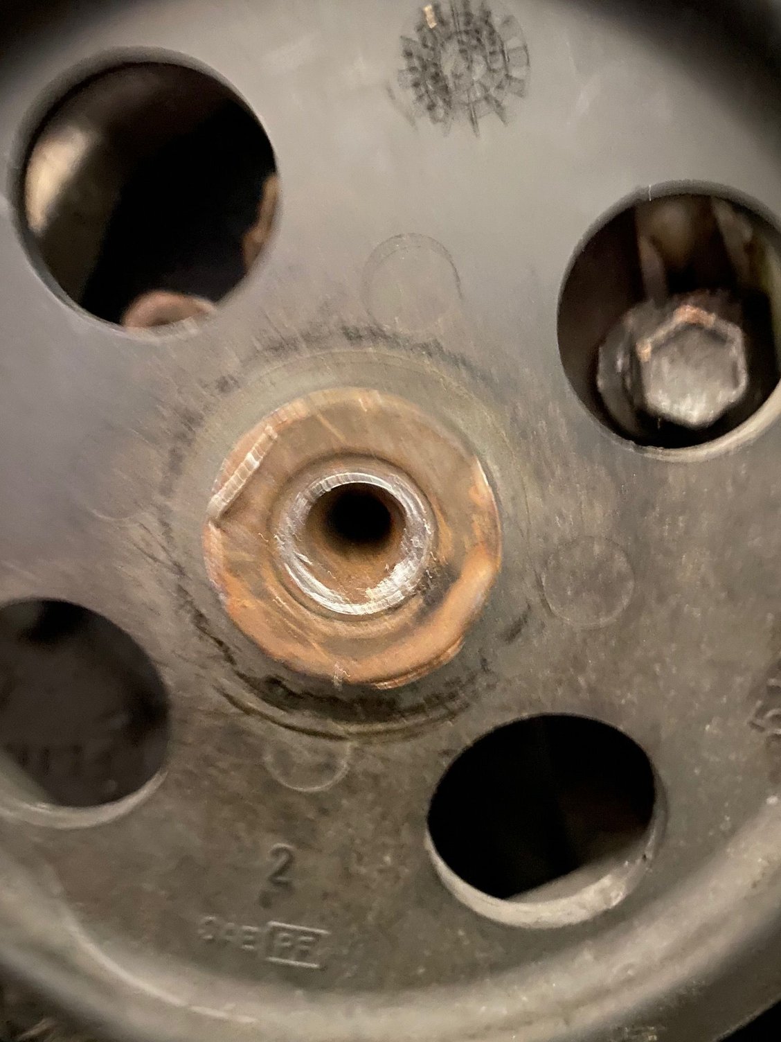

Alright guys, it's ironic but this is likely where the journey ends since I'm not paying a mechanic to make a house call.
I've now snapped that threaded piece off, half in the pulley and half inside the hollow puller (grisly photos ahead). I now owe the auto parts store a new puller tool (or will buy this one with the pieces I broke. Additionally, the remainder of the flange/lip around the pulley came off when I put the impact on it.
Mistakes made:
- I watched a lot of videos on using the puller tool and everyone did it differently. I should have been more patient to get the answer for my exact vehicle. Some people were using a smaller threaded piece on the end of the larger one and threading into the pulley, others seemed to not use anything going into the pulley at all, and others used a long non-threaded piece in there that just sort of went into the hole. Mine had threads so I assumed it was meant to be screwed into. May have been wrong. I'm not sure which was the right way for the Durango but I threaded assuming always better to have a hold and
- I ran the impact clockwise which I BELIEVE is correct from all the videos I watched, where I watched some people spin it for over a minute before the pulley came loose. That's why I didn't let up and eventually the weakest point (which I guess was the hardware and not the hold of the pulley) snapped and failed.
Ironic that a part I wasn't initially planning to replace (though with the dings I think I needed to) became the downfall before I even managed to get the new belt, engine fan, and clutch on there. I actually thought this would be the easier part.
I think I'm done, guys. I don't know how to remove a power steering pulley with a broken off piece of attachment inside it, and no flange to grab. I'm not going to remove the power steering pump and replace that too at this point. We're just getting into too much of a rabbit hole now.
Either I did this wrong, and caused the break, or the pulley was on so well that I did it right and it just caused it to snap anyway.
From the photos, you'll see the metal lip to grip on the pulley is now completely broken off, and half of the smaller metal attachment I used to join the larger puller tool attachment is inside the pulley, and the other half is inside the tool.
Pretty frustrated and angry with myself.

Take the entire bracket off, with the pump still attached. Then you can take just that part in to wherever someone can extract the broken part, and if necessary, cut the pulley off......

The pump was easier to get off than the pulley. A lot lot lot lot lot easier. You guys didn't tell me that. Pulleys suck. Holy cow.
And yes, as you guys predicted, I got mad, then, breathed a bit, then got back to work.
Anyway I sourced a used pump with pulley attached, got 'er on there today along with the new belt and the engine fan and clutch. I still need to tighten the fan clutch somehow as I have tightened it to the point where it's moving the belt, and I have to imagine it needs to be tightened further so I'll find a way to brace the new fan carefully.
