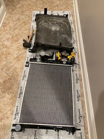

I have started to piece together my radiator and sourced a used electric radiator fan from a junkyard (not pictued), just a lower radiator shroud away from (I hope) enough to get the car running - just 2 hoses and 5 line connections away from that then, after re-assembly, that's sort of exciting to think this thing may run again!
The new fan and fan clutch are installed, along with a refurb power steering pump and pulley (when my pulley proved impossible to remove), and a new serpentine belt.

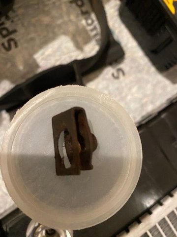

I'm now about to assemble the new condenser and radiator. In doing so I noticed there are clips on the old radiator to place over the holes. They are old and rusty and I'm having a tough time removing them. Any tips on an easy way to pry these off? I did manage to get one (pictured) and also, realized, one attachment point was snapped off in the accident and as such I am missing a clip. I suppose I will need to buy these somewhere? There an easy way to find the part number? I could then maybe also pick up some other bolts for the cooling system at the same time in case I am short.
That said, friends, if there are any other parts or tips anyone has to offer before I get started on the reassembly please let me know -- I would hate to get to a point where I am missing something critical. I'm going to try and attach as many pieces as I can with things apart which hopefully will make the unit easier to install. I'm a bit concerned over some other missing nuts or bolts given I didn't collect everything from the accident site, but hopeful everything I kept as I took things apart will be enough.
Thanks all - Hope to have another update soon. Here are some fresh photos from tonight.

If by clip, you're talking about the one on the plastic can lid, those are usually available at parts stores. Being low profit and volume, you may have to hunt around, and the bolt that goes in it may be a different size.
