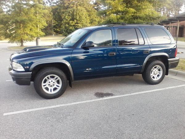

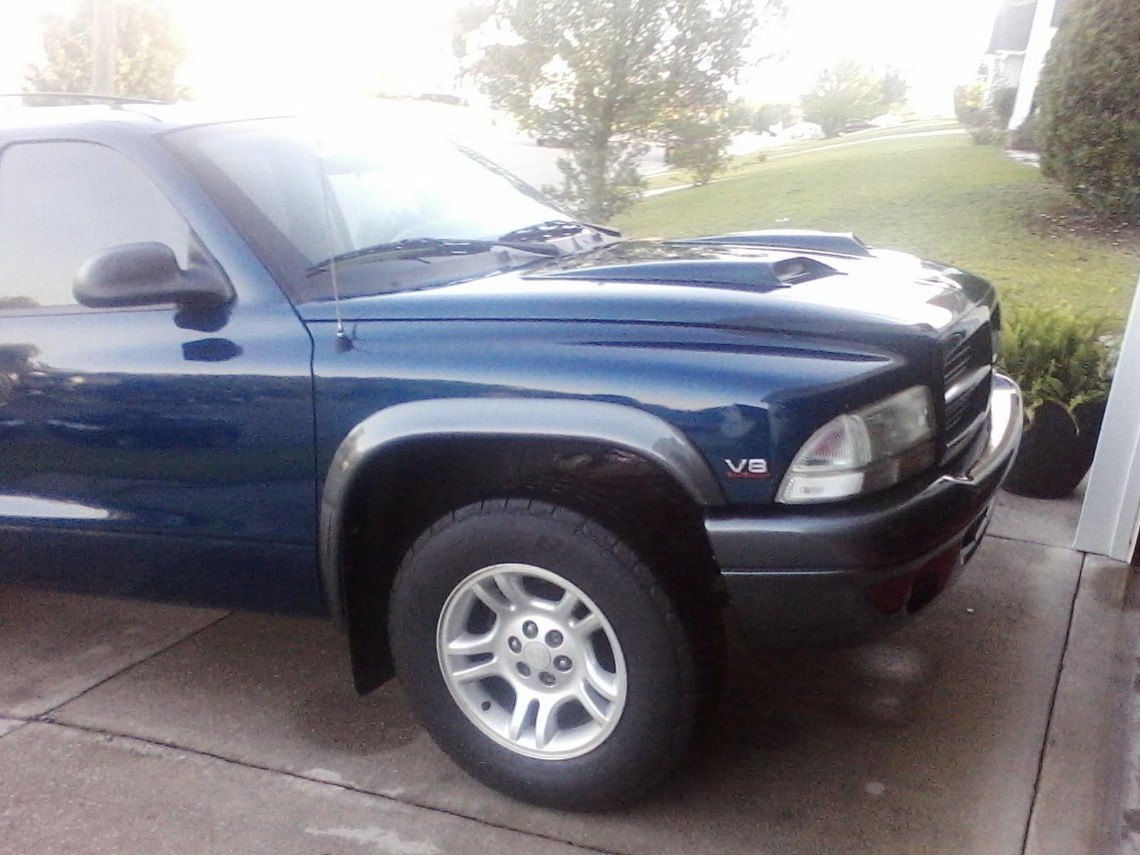

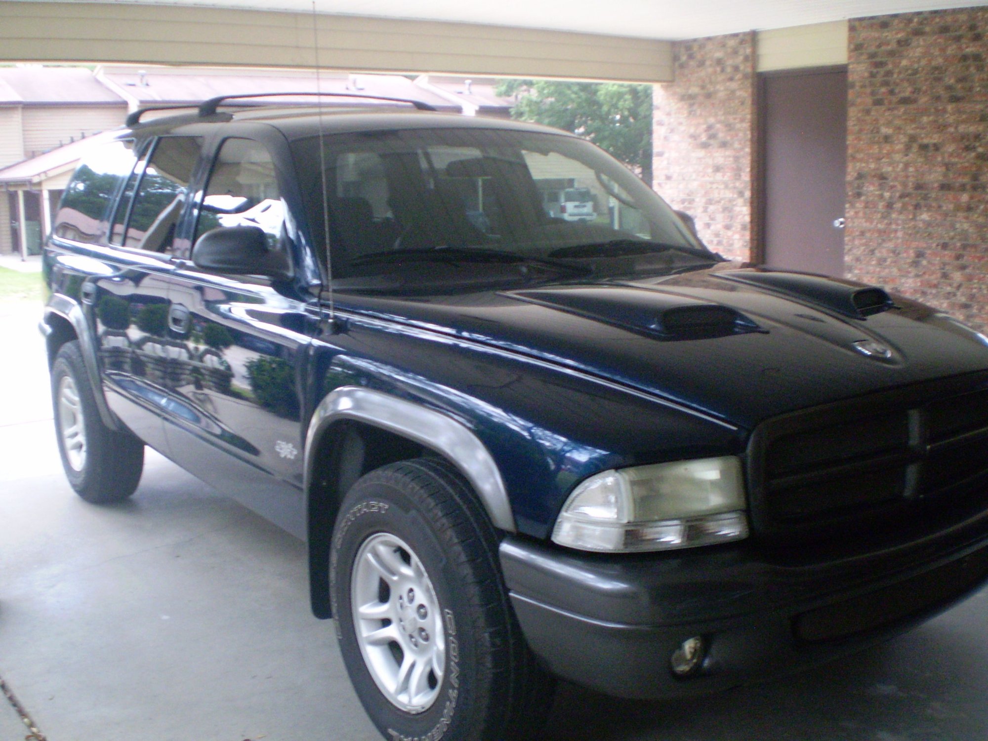

Thanks..here are a couple of pics...had her repainted last year in the original colors.

Looks great, bro.
