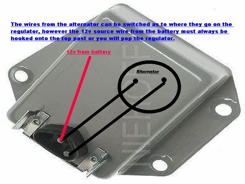

So you have voltage running to the alt in more than one place? If so that may be your problem. The voltage to the alt should only be at the large bolt on the back of the alt. The 2 field current wires go to the reg with an ignition pos to the top pole of the reg.

Well I finally got the old truck charging . I guess through all the testing and retesting some how the two vr wires got crossed and kept blowen the vr's so I fixed that and with a new vr I am getting 13.6 at idle! !! Finally I can drive the ole truck! ! Thanks guys for all your help and patience.
