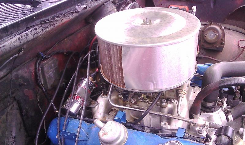

On one of your other post you were talking/asking about an air cleaner so you would not get mud in it. I have some pics of what I did to mine so I would not get mud in mine while at the mud bogges with it. I just put some flashing over the front half of my filter. I had to cut it to size and I left some tabs on it on the ends and in the middle on the top and bottom to hold it to the filter. My filter is also 5.5" tall so it really does not hurt it getting air. When your filter gets dirty you just slide the shild to the dirty side and put it back on. It makes it last twice as long that way.

hey thats perfect i think thats what ill do ! thanks

More pictures?
