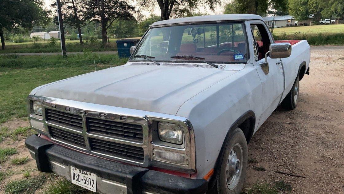

Looks to be the standard height for 2WD in the pic.There is not much that can be done with the control arm suspension as you found out. They do make lift spindles but not for your year.
