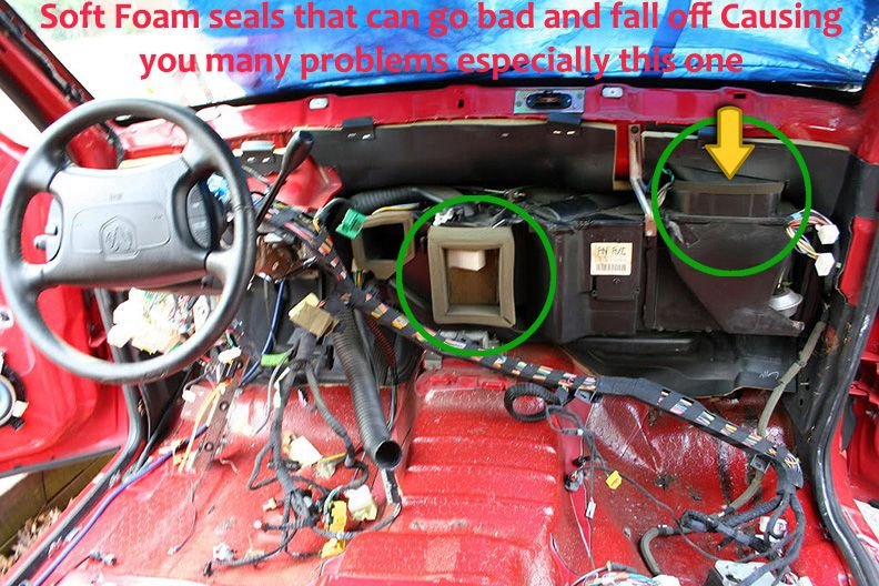

I'm a little confused about what is cold or should I say not warm/hot?
I'm wondering if part of your problem is cold air leaking into the cab from the HVAC unit the older Dakota's have a problem with a foam seal between the dash and the HVAC unit under the dash. Sometimes it rots off sometimes if the HVAC unit has been removed to be worked on the seal falls off or not replaced/installed.
This air leak can be very bad especially if its very hot or cold outside so no matter how hot your heater is its being drowned out by freezing cold air leaking into the cab.
This air leak can be very large.
