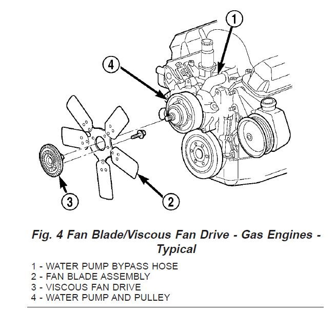

It looks like you are missing the shroud it is #4 on the second Pic and the other pic shows the fan assembly this is out of the 2003 service manual.
I could tell you were missing the shroud as soon as I saw the Pic you posted as they covered the fan by a shroud for your protection back around 2001.
Pic #1
Pic #2

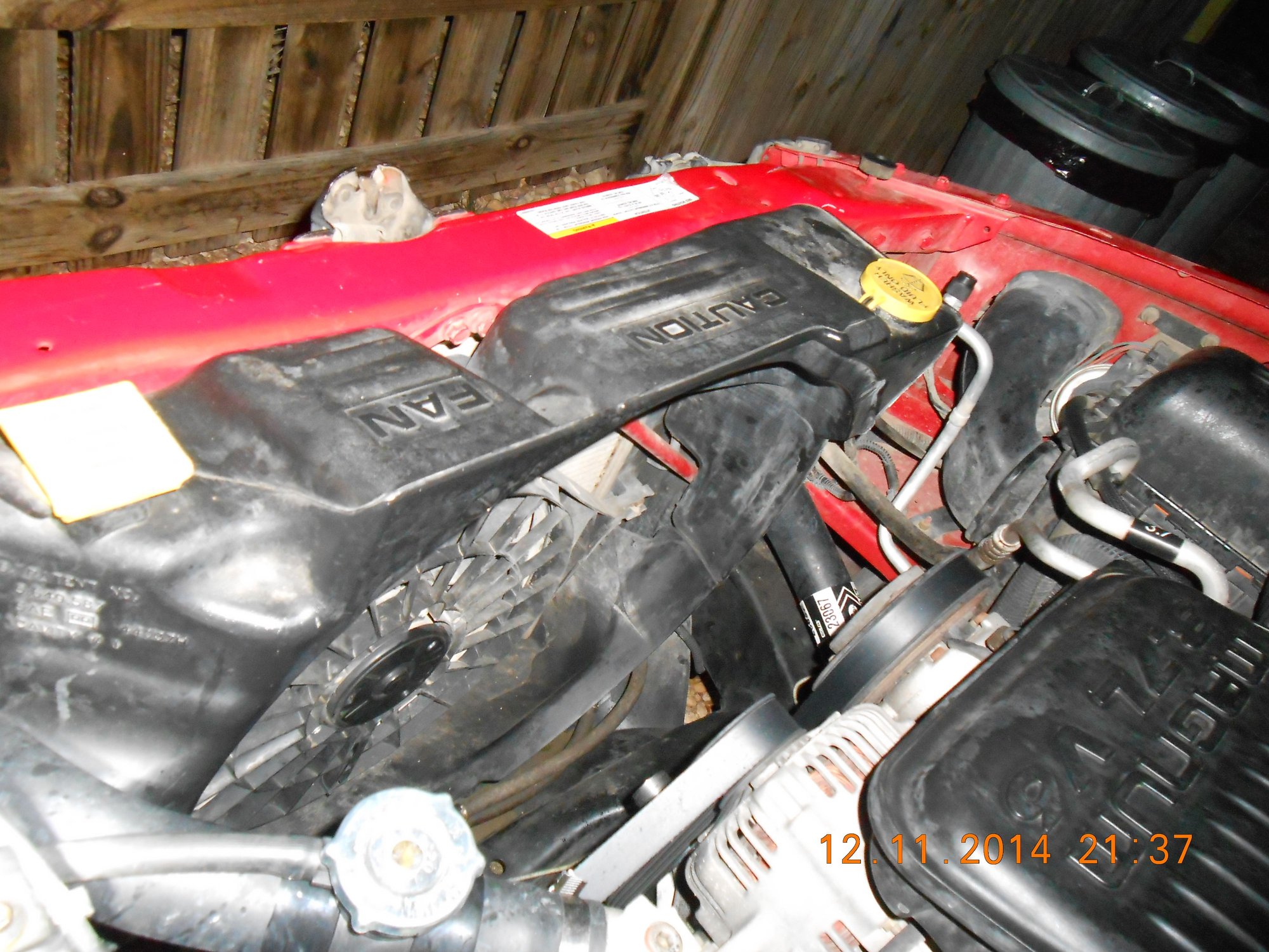

That is a TOTALLY different assembly. Not even close to OEM.

Thanks! Yeah, here's the new one, I've gotta check for the mounting points for the #4 piece and see if that matches up.

OK i guess it is similar, just a different shaped clutch. Never did understand the unbalanced fan blades.
IDK if it's a motor/year thing, but the photo DakAz posted doesn't match my 01. But your pictures do- if you look, there should be some little M10 x 3/4" studs sticking out of the fluid tanks. 3 on one side and 2 on the other. I shredded my lower shroud, but still carry the upper shroud and clutch fan in back of the truck in case I need them.

Yeah, today when I had it stuck on there for the "mounted" pics I had the fan turned the other way, but when I saw your pics I turned it around the right way. Here's a pic of the place where the #4 would mount, but I don't see where it can, no blank screw holes or any place to attach it that's obvious. But, I'm in agreement with you, something is still missing in a big way. I don't see how it's gonna pull through the radiator with that much wide open area. What I'm looking at is two piece, an upper and lower, I don't see any studs sticking out.
