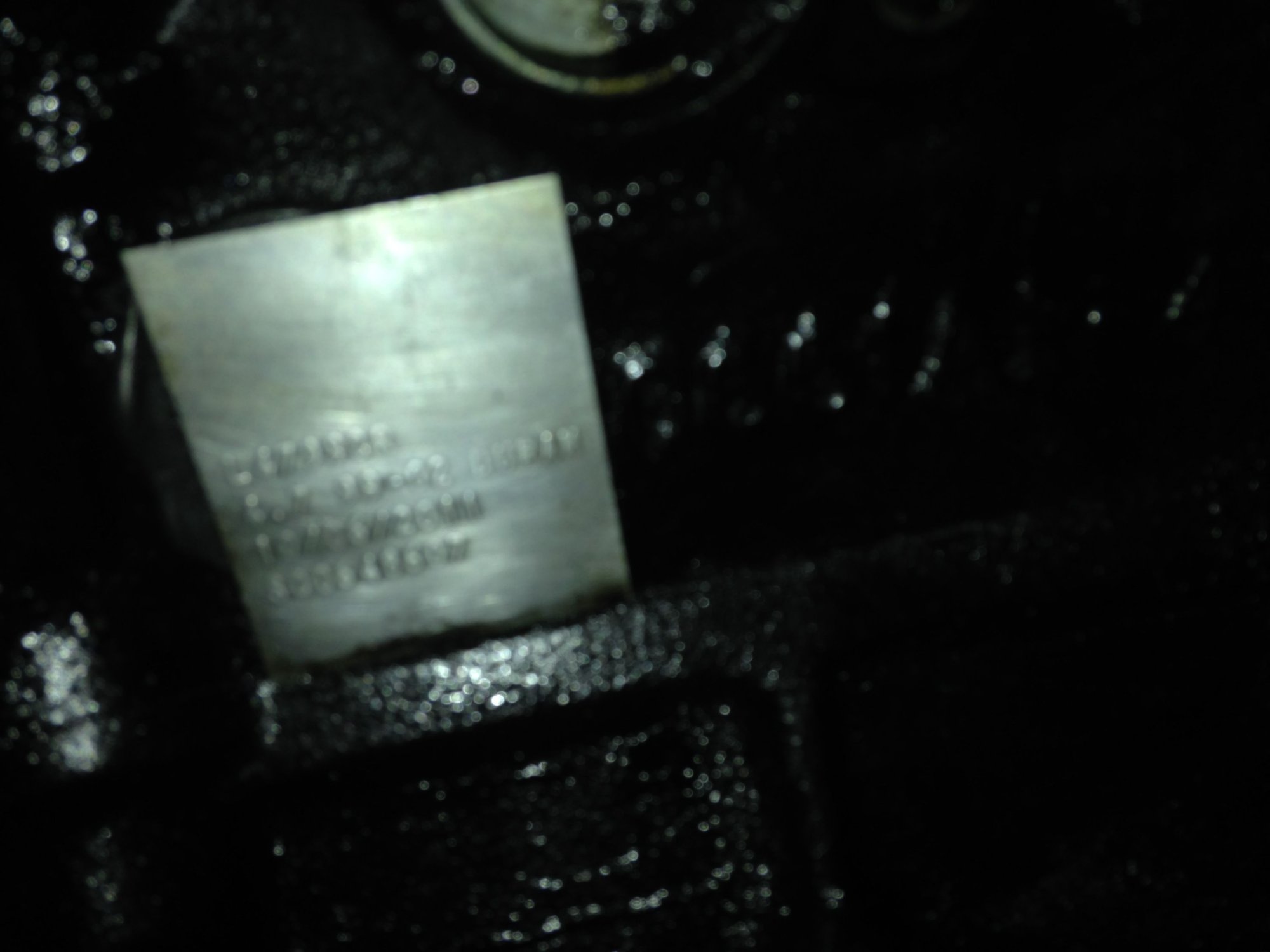

Old Feb 5, 2017 | 10:02 AM
rlordjr's Avatar
rlordjr
Joined: Sep 2007
Posts: 28
Default Reman?
looks like I got a reman from 10/2011. Here's a pic of the plate. Can't read it in the picture but I wrote it all down and will post it later. Maybe someone recognises whose plate this is
Old Feb 7, 2017 | 10:48 AM
rlordjr's Avatar
rlordjr
Joined: Sep 2007
Posts: 28
Default pictures!
Well after pulling the old engine we can see the end of the casting numbers are the same and also were able to relocate the engine brackets. Have to swap the 4wd headers onto the new engine, swap valve covers (hole in one of the newer composite ones) put on new water pump, belt, idler, hoses, throttle body etc. Headers and mounts seem to be the only differences between the 4WD and 2WD engines. Here's a couple of pics

Old Feb 7, 2017 | 05:41 PM
magnethead's Avatar
magnethead
Joined: Feb 2005
Posts: 8,058
Likes: 183
From: Fort Worth, TX
Double check that oil pan. I could have sworn they were different.
Old Feb 8, 2017 | 09:59 AM
rlordjr's Avatar
rlordjr
Joined: Sep 2007
Posts: 28
Yep I looked again and they are slightly different. Check out the new thread I started to try and ID the rebuild tag. Then I'll start ANOTHER to chronicle my coming fracas with AM Used Auto Parts - they shipped me a supposedly run-tested motor and when last night I went to change the VCG's found that 3...3! rocker arms were totally missing on one side - and another one fell out - basically every other rocker arm on the right side was out of place or missing!
Old Feb 8, 2017 | 08:38 PM
rlordjr's Avatar
rlordjr
Joined: Sep 2007
Posts: 28
Well my eyes deceived me. The rocker arms were there they just fell out and were in the oil channels. Ha, ha it's amazing what sunlight will reveal. Still trying to find a 4x4 oil pan as I can see the different profile between the two but the original 4x4 pan was ruint. Anybody know a site showing the two?
