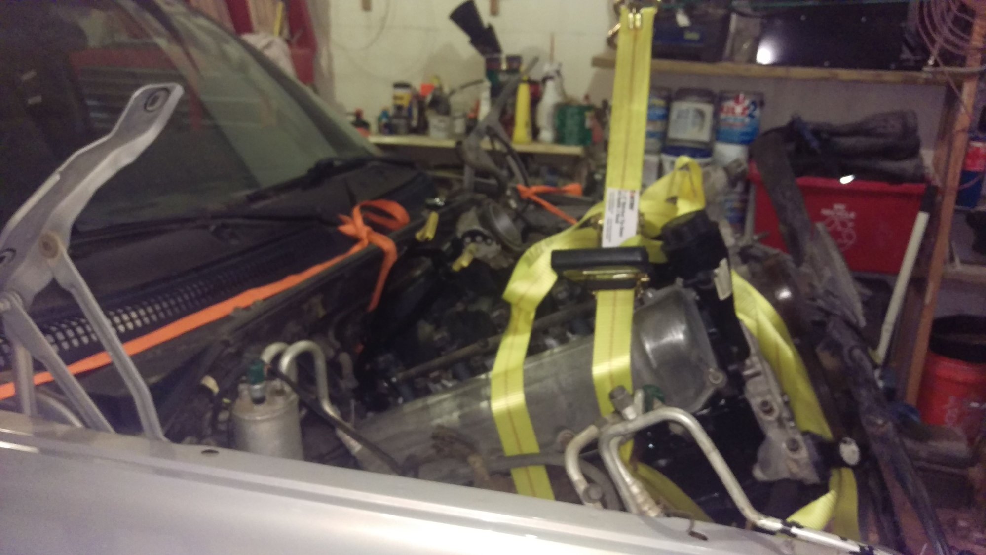

4.7. I have the rebuilt transmission and re-manufactured engine back in the truck. I have put most of the accessories on the engine from the old one. I put new cam and crank positioning sensors in. The oil pressure sending unit is the same but that one is easy to get to.
As I was going through the parts in the back of the truck I found that I had forgotten to get the transmission cooler lines in place and now I am having trouble getting them weaved between the engine and frame to get them back in without fear of kinking them. Thinking of cutting them in a strategic location and splicing them with a compression coupling. Is that sound acceptable? I believe there is only about 30psi on those line and a brass coupling should be high enough quality or am I missing something?
This part was easy but had to remove the hood to get the lift lose enough.
From this point on it was really tight but managed to get it on the engine mounts in about an hour.
