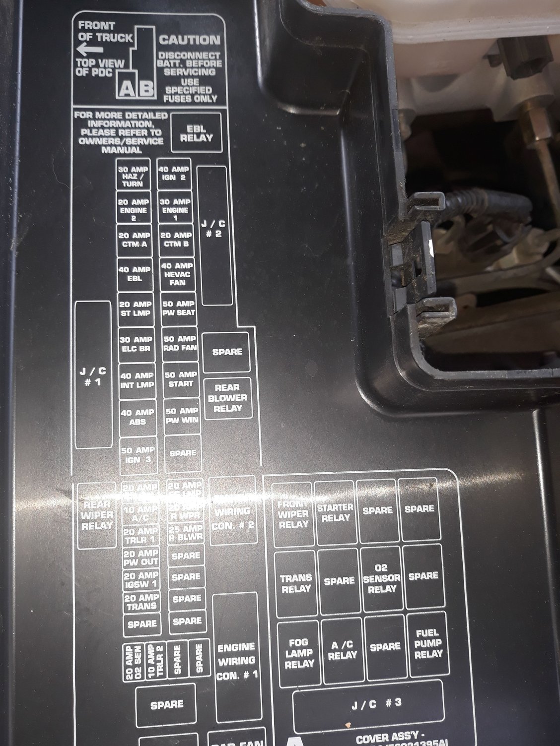

Yes ASD its also called engine relay an on mine its beside the fan relay in the lower left corner [ cut off in pic] under spare.
But yea it sounds like pump issue but check wiring to it also.

I may try the Delphi. Denso doesnt make the 24 gallon tank pumps or at least there isn't one publicly listed in their catalogue and since I have to drop the tank again. I did swap out the asd relay with ebl to no change. I used the iac wiggle test on my ds708 and I will say that was almost as impressive as holding the throttle open to 60%. Constant rpm up and downs and fuel pressure behins to crap.

So it dropped to 45 PSI over the course of an hour. Also noticed now that the pump can be heard clearly while running and the pitch oscillates up and down. Definately starting to think the pump is faulty. I cant determine if any of the injectors are causing a problem yet. Scan tool indicates ASD is engaged up until the engine stalls (Still cant find this relay)

So this is a video from basically start to finish. Engine is off over night. I crank it and toggle the throttle. Please excuse the stability of the video. Also I have a delphi pump coming and yesterday I played with sorting several relays into the asd as well as the fuel pump.
