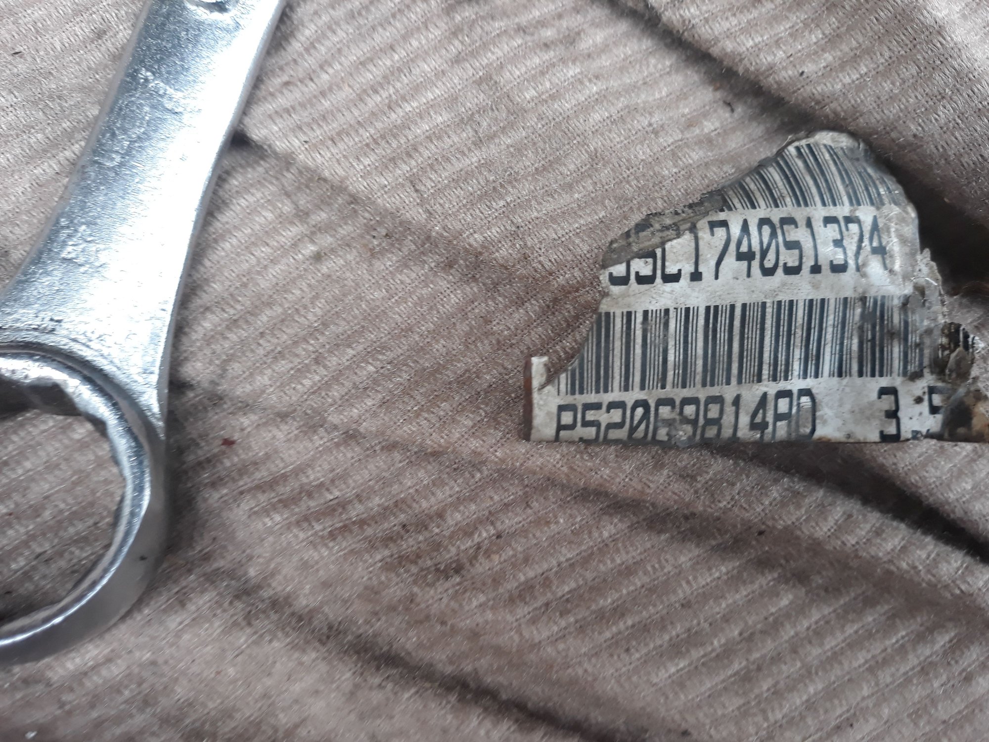

I did see a tag on it.Ill try to get tbe #s .
Where is the build sheet ?
I will look for the similar setup 8.25 base with the same mounts .
A 10 bolt diff on 2wd base model should match up.. I wasnt sure if internal set up differed .

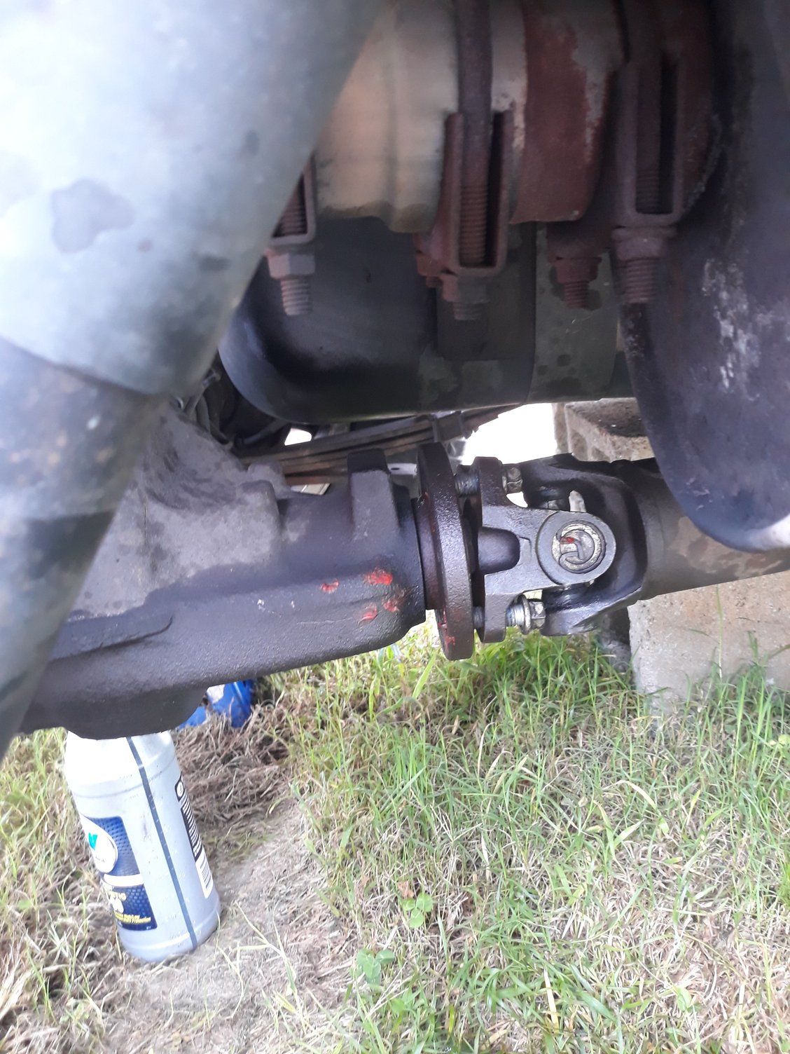

Old Sep 15, 2021 | 11:06 AM

heres a tag i found .says 3.9 in corner.
Theres my type

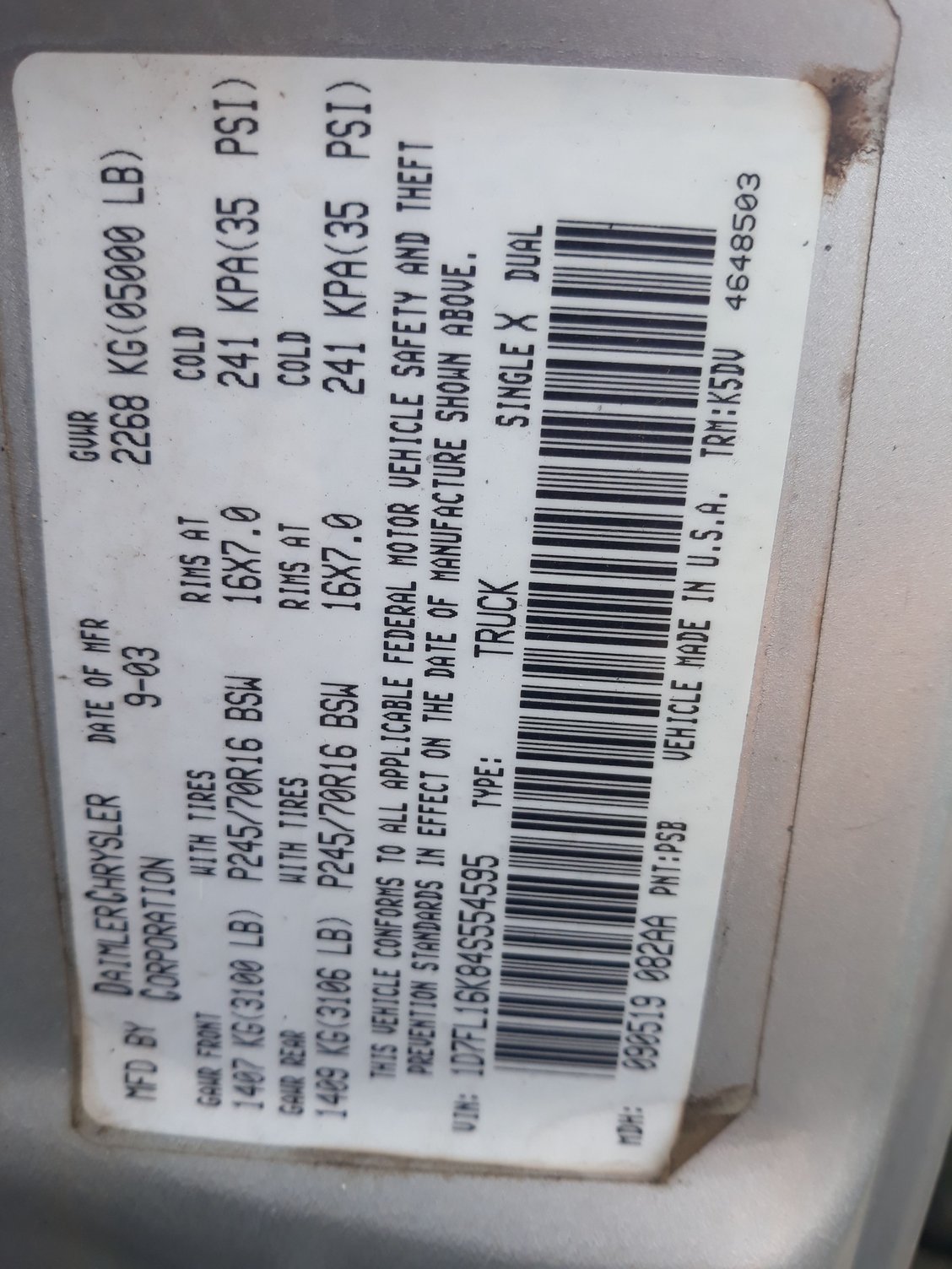

Heres the one im looking to get..does this tell much .?
an what if its LSD . I need to turn wheels an check..
Everything looked identicle ..so hopefully no issues .

Here's what I get.
Equipment Listing
VIN 1D7FL16K84S554595
Vehicle Description 2004 DODGE DAKOTA P/U REGULAR CAB 4X2
