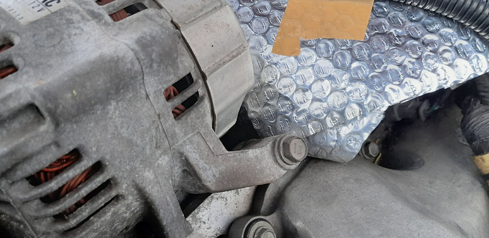

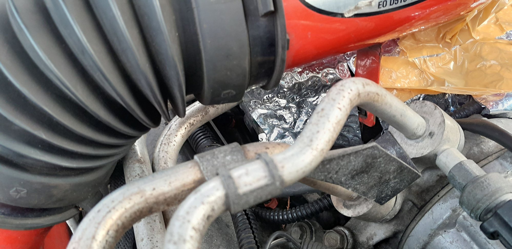

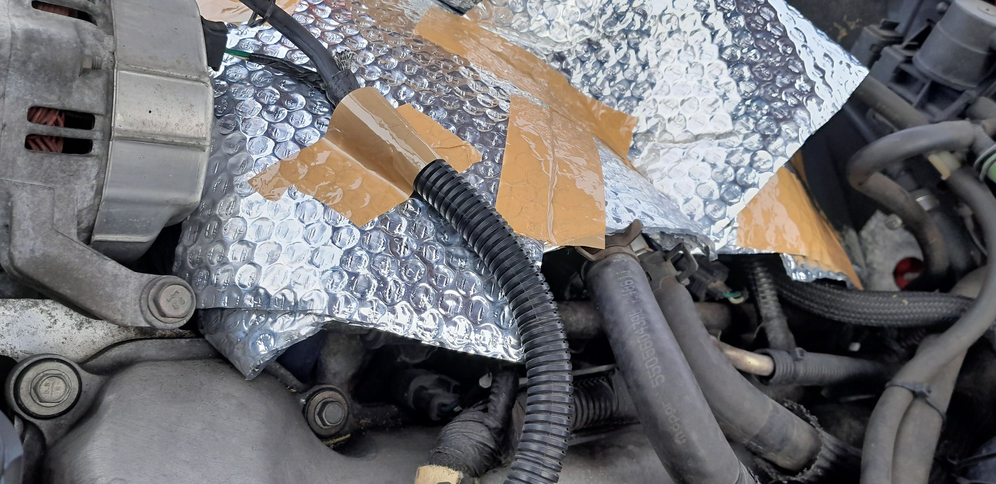

Well, hope it doesn't bite me in the @ss....it's supposed to withstands heats up to 176 F, sure hope it doesn't melt, i've got a fire extinguisher ready on the passenger side....just in case.
Overall Coverage, most parts are tripple layer.
Dual layer vertical behind the AC and Altenator
