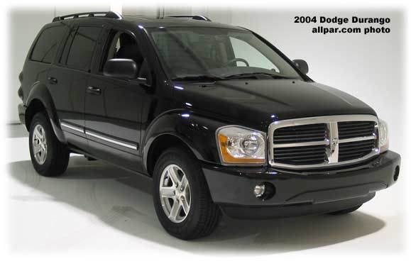

Originally Posted by magnethead
Nope, only the body changed for those years. The chassis was the same, at least at the wheel ends. Chassis changed to 5-lug in 05.
I went to the junkyard, found an 04 durango, knocked the 4 balljoints and 2 tie rods loose, and came home with a heavy, expensive, full wheel barrow.
Knocked the 4 and tie rods off my 01, bolted on the 04's. Brake lines, ball joints, tie roads are all the same.
04 Durango is five lug. https://www.carparts.com/details/Dod...E&gclsrc=aw.ds
Just so we are clear, this is an 04 durango.
https://www.allpar.com/d3/model/durango-2004.html
