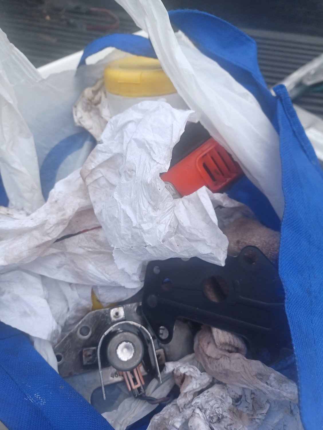

I stuch another assembly off the same type tranny which included the transducer an gov solonoid.
So far its ok...Ill soon see.
It oddly took 6 quarts to get it back to correct level[ NOT 4 as all parts stores say]
Is there a test i can try on the old gov solinoid ,including the transducer ? Just curious?
Old May 17, 2023 | 04:28 PM
  #22
Posts: 87,403
Likes: 4,214
Not testable as far as I know.... at least, not without some pretty specialized equipment....

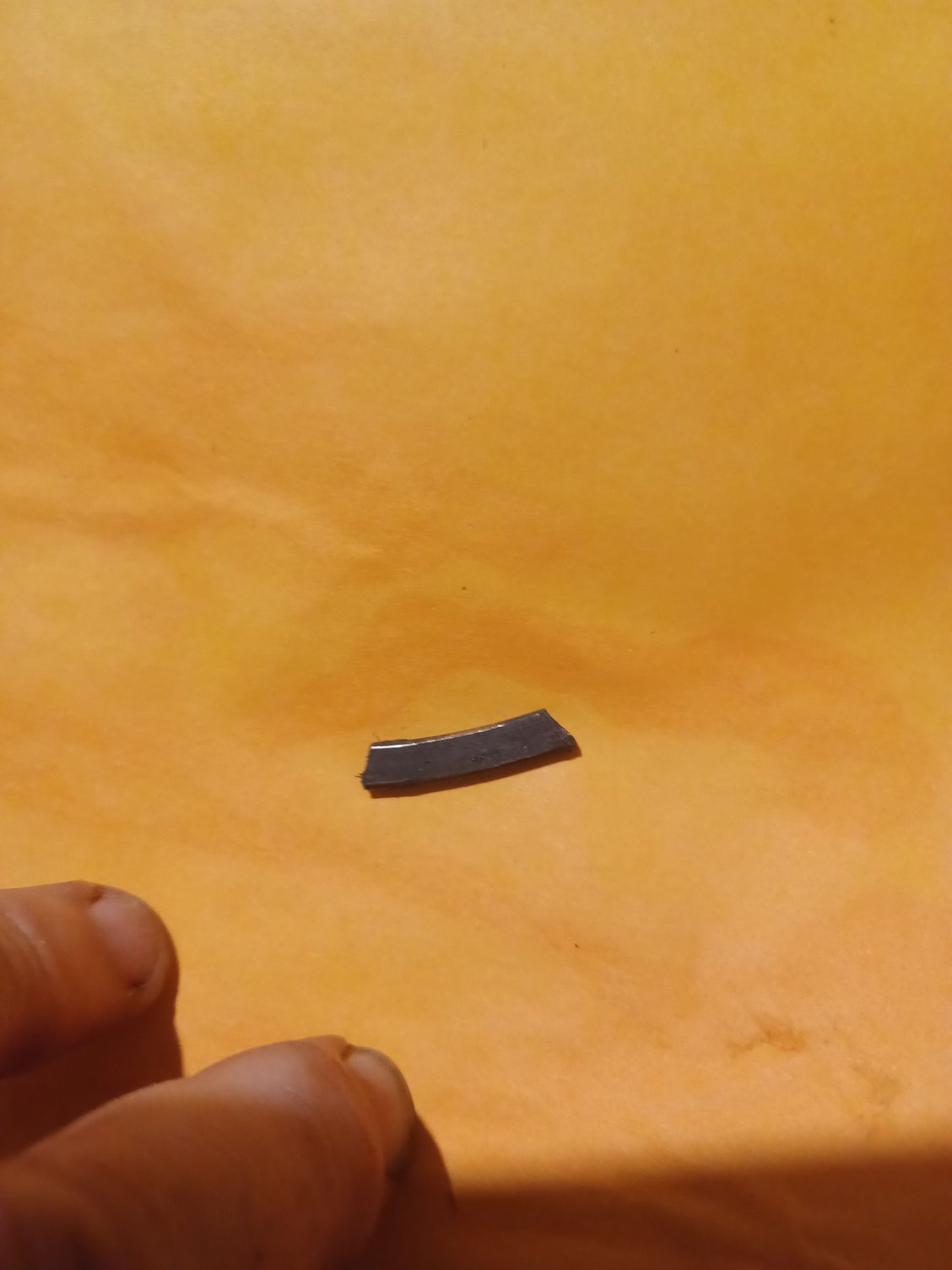

I did find this at the bottom of the pan ..not sure if its part of that ring piece. Any idea?
Old May 18, 2023 | 03:36 PM
  #26
Posts: 87,403
Likes: 4,214
Yeah, looks like part of the O/D snap ring.... it's a small piece though.

That fixed it!
