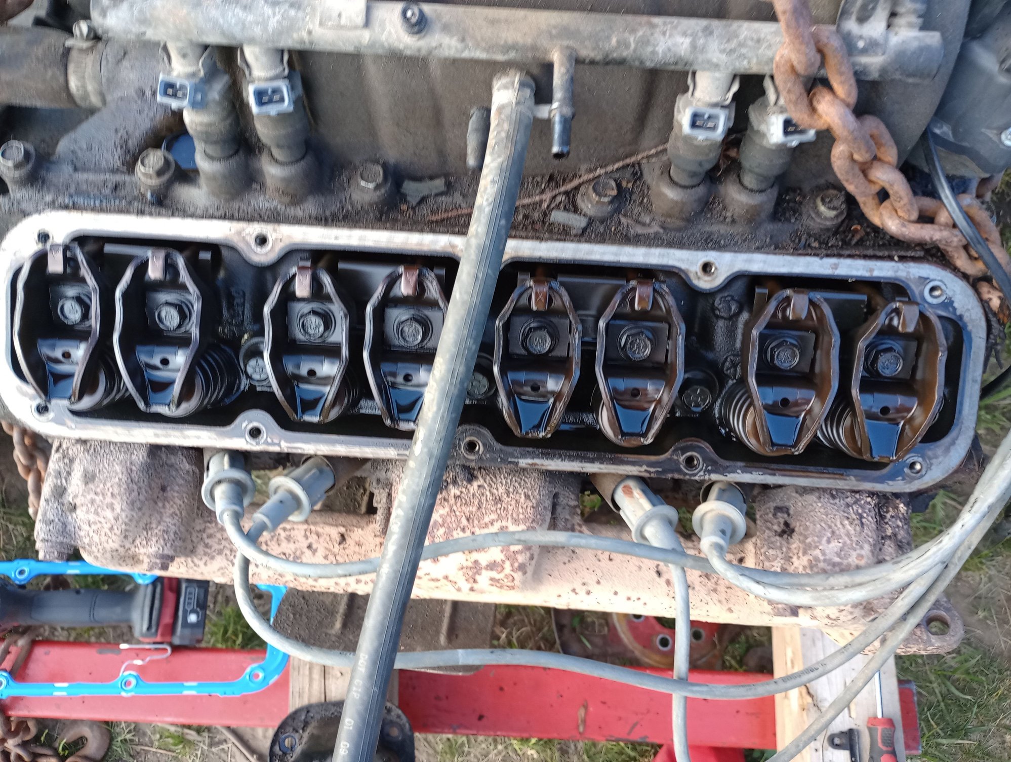

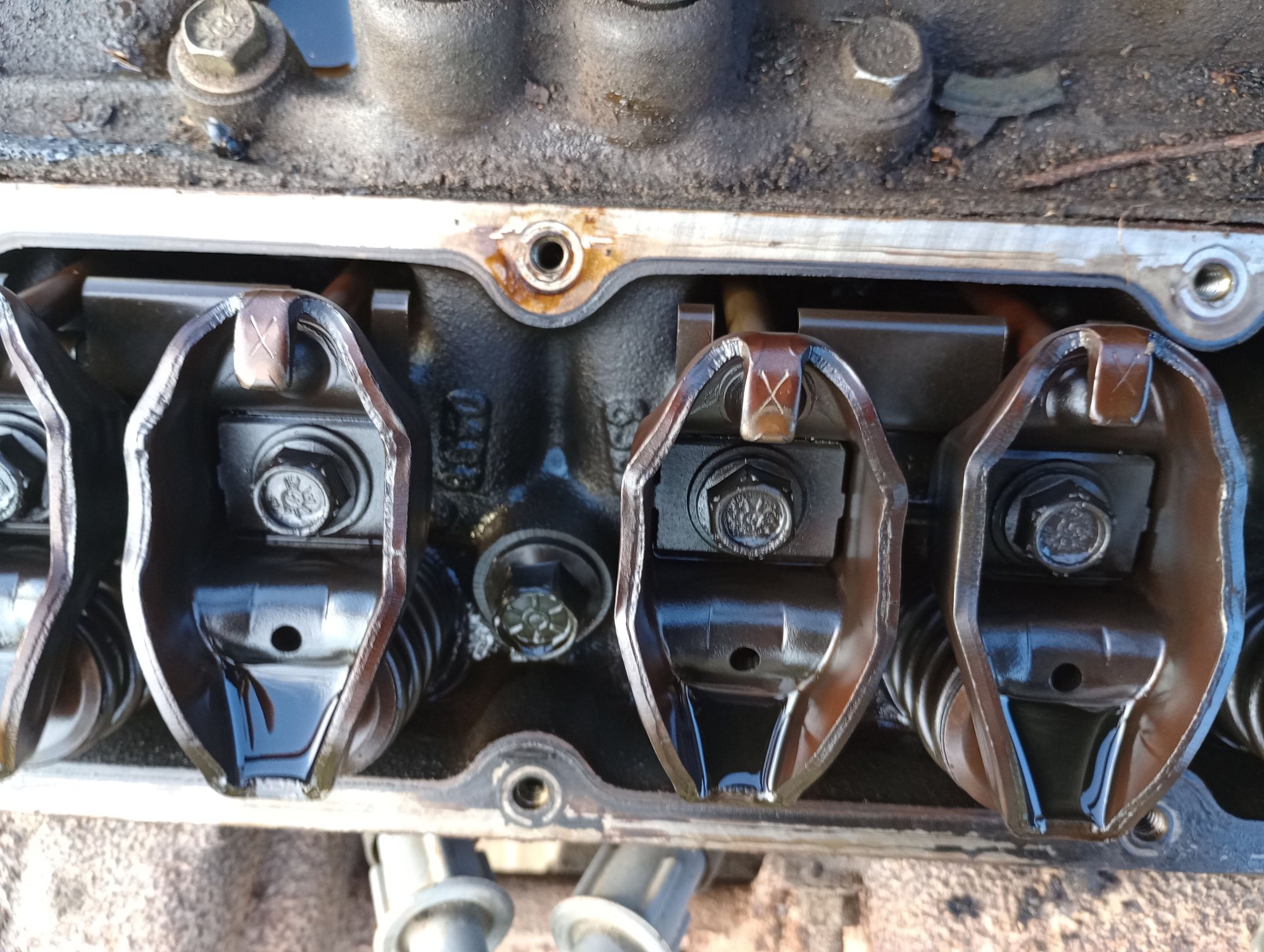

I Used the 5.9 rt oil pan cause I figured it would be accurate, the 3.9 pickup tube, and put some new valave cover gaskets on it, the inside of the motor looked like it was just built that day. I have pictures, tried the breaker bar but it won't move either way. I might have to just pull it and see what's going on
